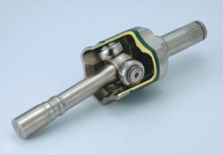

2 days ago, I heard a loud metallic noise while turning a sharp corner. Later found out one of the bearings in one of the inner CV joint was broken. Replaced the whole driveshaft and the tyre noise was noticeably softer, but it's still there.
Just in case for those who doesn't know, this is how the bearings of the inner CV joint looks like.

QUOTE(kingsleysoh59 @ Mar 16 2013, 10:51 AM)
hmm perhaps inspect the wheel bearings, tie rods/bush etc? tongue.gif (loud metallic noise should not relate to tire noise anyways)

QUOTE(Quazacolt @ Mar 17 2013, 02:29 AM)
The above parts you mentioned and a few others were checked at the same time while replacing the driveshaft. My mechanic says they are all still ok.
Anyways, I can live with the current "lowered" noise.
