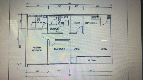

The house is 1100sf.
I believe the space that I would like to use for 1 Aircon is 550sf based from the floor plan

Dining wall faces which direction? Ensure ceiling 11ft min. 550sqft will vary between just over 3.0 to slightly over 4.5HP depending on balcony orientation. If dining wall faces south or southwest, it will get hot...even through the night. Compressor will likely be place outside in the balcony.

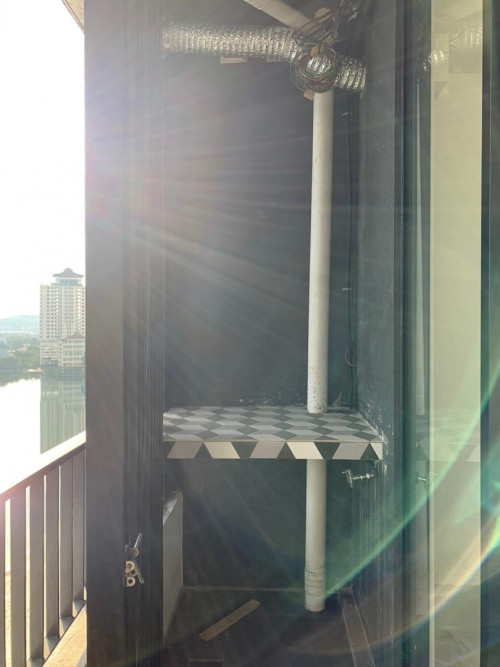

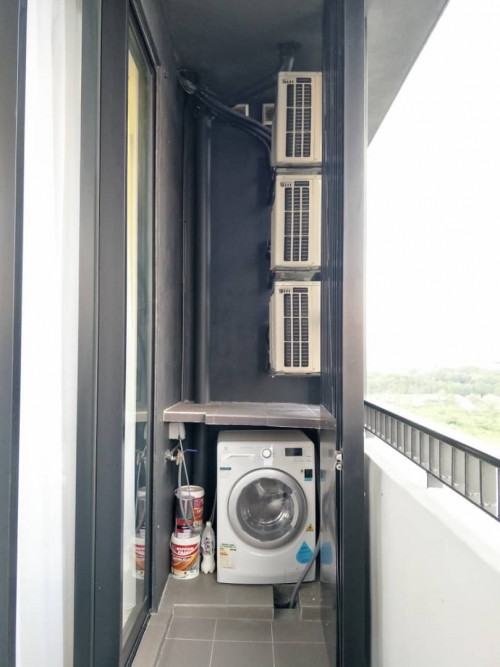

unfortunately after measuring the compressor area, I won't have enough space for a slightly bigger cassette compressor. There is enough space but only if all 3 compressors are stacked on top of each other without any spacing.
cassette compressor = 875 w x 695 h x 320 d
split compressor 2x = 718 w x 525 h x 255 d
btw I already have piping in my condo done by the developer, can I change to this higher end piping?
or would it be too much work for the ac guy to change the piping?
i assume the piping will be more leakproof hence worth the extra few hundred investment.
thanks

QUOTE(barca96 @ Nov 8 2020, 03:16 PM)
thank you very much for your advice.
thanks
On the right to the compressors, what is the grey thing from ceiling to floor ? Solid wall ?
barca96
post Nov 8 2020, 04:32 PM
980 posts
Joined: Apr 2010
QUOTE(mini orchard @ Nov 8 2020, 03:39 PM)
yes a wall between my balcony and inside of the house.
forgot to mention, another problem for me is I installed a kitchen hood ventilation.
perhaps the installer should've installed it right at the top of the ceiling instead of lowering it.
at the top there is already bathroom ventilation and water pipe. so should've kept everything up top.
very troublesome designing this house due to the limited space.
there is not even a space for shoe cabinet, no window at the kitchen for ventilation.
could be happier but still satisfied all things considered.

The compressors need to blow away the hot air to an open area and I think the direction is wrong. The compressors fan should face you when you look at it but then you have a problem using the wm when the ac is running.
sorry what is WM?
the developer actually point their fans towards the balcony as you mentioned but my aircon guy said we wont be able to ist at the balcony then and most of the owners here also point it outwards as per pic. It is partially blocked as there is a sort of grille design.
thanks
There is such a thing as a multi-split system where one large compressor services up to 4 locations depending upon the model. One compressor to one location is typically called single split. What's deployed at each location doesn't matter as long as it's within piping spec. It can be wall mounted in bedrooms and ceiling cassette in living / dining not exceeding total HP of the multi split compressor. These are common esp in SG typically referred to as system 2, 3 or 4 depending upon the number of AC locations.
The wall where the three AC compressor is located should be blowing out into the void with multiple thin pillar grille screening so that there's unrestricted air flow otherwise the compressors will die of heat stress.
This post has been edited by halcyon27: Nov 9 2020, 03:12 PM
barca96
post Nov 9 2020, 07:25 PM
980 posts
Joined: Apr 2010
QUOTE(halcyon27 @ Nov 9 2020, 02:44 PM)
Hi yes I heard about that but my aircon guy told me not to get it so I didn't. It would've saved me so much space.
QUOTE
Sorry. Is it correct as it is or it should be turned?
halcyon27
post Nov 9 2020, 08:34 PM
2,140 posts
Joined: Nov 2010
QUOTE(barca96 @ Nov 9 2020, 07:25 PM)
If it's blowing outwards it's correct. If it's blowing inwards, it will blow hot air into your balcony area. So where is it pointing?
