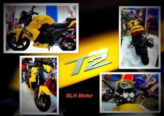

how bout this?
sym t2 250.

ya, last time i order the megelli 250 but out of stock .the motor shop staff recommend me to buy this sym.but i dont want,coz i like megelli style.

ts bro, this is the same as urs? damn hensum wei yerrow karer
..i hope got dealer here in swk

QUOTE(themanwithnoname @ Sep 15 2012, 07:06 PM)
Yup..yellow color will be available end of September. U can get in Sarawak first cause the all megelli motor will be shipping to there custom than only shipping to johor.I believe u can be a first yellow color if u booking it now.

wow!!! menarik.. megelli naked menarik perhatian jugak. hehe. ada beza ke performance between 250rr & 250sr??

QUOTE(mshahrila @ Sep 20 2012, 05:19 PM)
Nop, is same engine and fame. Only the Look is diff , but i have to tell you 1st the naked still got some problem on ( 1 way ) . As i know , the all second batch have alot of problem now.
