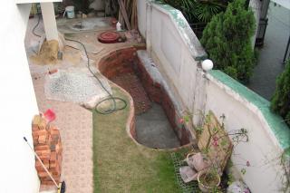

Believe it or not I built it on my own! RM2K and later spent another RM1K for water proof and other filter stuff and pump.
For a good koi pond you should have one far end for water return and the other far end with bottom drains going into the filter and pump chamber. This will give you a straight flow like a river that flow one direction.
If you use the old way where the bottom drains (BDs) are located at the middles of the bottom pond you would have a circular flow that confused the fish. The old way also need you to have one third volume of chamber vs the pond volume where the filter chamber took too much space.
Newer method is to have a lot of aeration and some external filtration system that you need not have to have large filter area for filter chamber.
If you hire someone to built it could cost RM20 to RM40K depends on size and stones that you need to decorate the pond. I just did little decoration. Sometimes simple look nice depend on individuals.

No lori. I used my car. Putting the soil on bags, load into my car drove for some distance and throw and bring back the bags.

Some pix
Added on February 18, 2012, 12:04 amToo many trips but it was some 500meters away only. It was soil filling low land, not rubbish ma.

Great man thinks alike, bro. the space at the back portion is 3 times larger but the other half territories so got to do with half 8.

Digging was not a problem. It is easy with fork (see pix), no much effort even rocks and stones come out easy. The work was putting it in the bags and transporting it to dispose that take much time and effort.

yr fish pond if dowan to get greeen algae color then dont expose to the sun ... else get a uv filter that is approriate to yr pond size
mine is square 20ft x 4 ft x 4 ft height ... fully green color ... but then i put soon hok, patin, talapia, catfish inside laugh.gif

With properly designed pond and good filtration you will not have green floating algae. My pond is expose to sun most of the day.

wow...really nice pond. Planning to do the same with window panel (raised pond).

WOW Stevie, that’s an nice looking pond.
Just wanted to share my small pond for 2 koi fish I have, had it for almost 2 months now. The pond is pre-fabricated. Not much issue except algae, don’t know how to get rid of them
