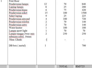

Hi,
Need your opinion on weather this price for wiring is reasonable or not.

thanks for the price reference.
i think the price that a wireman quoted me is around the average market price, comparing with yours.
