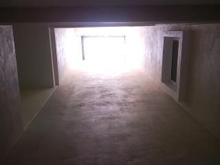

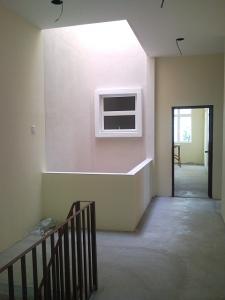

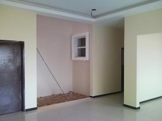

hi,
need some advise here.... my new house has an air well which i would like to convert into an indoor garden on the ground floor... plan to put an foldable / zig-zag glass door there...
as for the 1st floor, i am still thinking of what to do, putting a whole glass of tempered glass to cover it looks nice but i wish to open it some time to have better air circulation. but then, to put window there feel like ugly... sigh.... anybody got any suggestion?
thank you in advance...

I suggest you put a polycarbonate roof.
1st floor just leave it as it is.
Ground floor you can either put a frameless laminated tempered glass with door or just leave it like this.

this is neat - i like it. i dont know about your budget what i would like to do with it is this:
1. close the top with a tempered glass plate rised maybe 1/2 foot stuck on stainless steel bolts; plate should ideally have slanted sides to prevent rain from pushing its way in though.
2. for the first floor i would close the side facing the door with a tinted or milky glass panel (frameless if possible) and closing the other side with a sliding door (50:50 space separation)
3. ground floor i would also opt for a sliding frameless glass solution (clear). folding looks like it provides too many trouble parts.
sliding doors i would use a hanging system with a seal so you can really close the area if you want to but you can still open it when required. shower screen ppl should be your friends. just make sure you get small door knobs and not the horrid rails.
reason: good light inflow like this, retain option to create ventilation where and when required, hot air can escape through top, oxygen gets in. you can enjoy the green from ground and first floor (i.e. grow some wall climbing plants).
