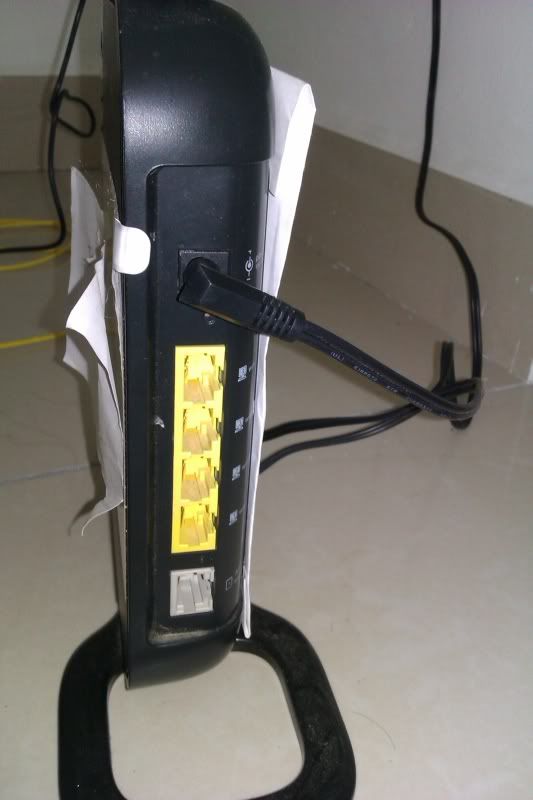

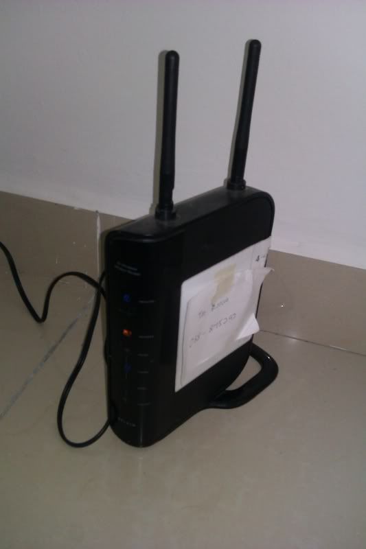

ok so i am quite noob in networking...
i just move into an apartment and subscribe to the apartment jaring fiber optic internet service
now i can connect it to my laptop but there are 3 laptops in use at home so i need to make a wireless network, i got my ADSL modem router from my previous line with stremyx, but i dont know how to make it wireless with the current jaring network.. i connect here and there, cincai connect tried couple of ways oso cannot get it connected. so please some one help me please... notworthy.gif
heres the stuff....
so what i did was to connect the belkin router using the yellow ethernet wire and connect it with the mitsubishi modem... but there is no light on the internet connection line at the belkin router..

i dont know much.. but put that yellow lan port cable on mitsubushi to belkin wan white port to go wireless.

the blue-yellow cable is phone line(RJ45)?
PS: if you by pass the router you can connect to internet without dialing through your laptop?

Phone line is RJ11, phone line is RJ45
which would be the 2 white port on the mitsubishi modem,
the yellow-blue looks like single-mode fibre
TS,
How are you connecting it to ur laptop now?
I assume you connect Port 1 from modem to ur laptop, right?

i can connect to the internet 2 ways,
1- straight conncet the yellow line from the mitsu modem to my laptop,
2- connect the mitsu modem to my belkin router and connect another yellow line from the router to my laptop
so is that means the router can actualy receive internet connection from the mitsu modem but i cant received wireless connection from the router to my laptop?
is it something to do with the belkin router set up? do i need to re- set up it since i am using jaring now?

TS,
Your setup should be like this
BTU (The Jaring box) >>>[yellow-blue fibre] >>>(Fibre Port) Mitsubishi box (Port 1)>>> [LAN cable] >>> (Wan Port, White) Belkin Router
Here's what you need to do:
(Assuming you have access to the modem)
1. Plug a LAN cable from Belkin to your laptop
2. Access your belkin router
a. Change the WAN from PPPoE to bridged
*From here, you should be able to get connection to the internet already
Once it's okay, you need to stop duplicate DHCP servers
3. Plug LAN cable from Mitsubishi modem to your laptop
4. Access the modem
a. browse and disable DHCP server
TSah_suknat
post Aug 19 2011, 02:26 AM
whoooooooooooooop
5,170 posts
Joined: Jul 2006
From: /k//k/, /k/undasang
ok now i can connect to my internet wirelessly...I dont know how I set it up ( I think i change the pppoe to bridge) but now the connection is not secure anymore...any one can access to my internet...so how do i make it secure again?
