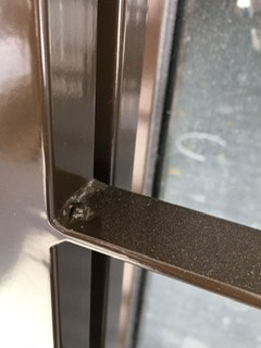

pic of my house grill taken just now, 5mm x 25mm flat bar on 1"x2" RHS
Attached Image Attached Image
QUOTE(Jo_da48 @ Aug 16 2011, 08:51 PM)
I guess it was correct, stardard sliding door grill are using 0.5" bar where internal are empty type and it squre.
Is not the thickness on the metal lal.
the std SHS/RHS 0.5" thickness only <=1mm, so its very light and can be cut easily.

QUOTE(Jo_da48 @ Aug 16 2011, 10:14 PM)
My Grill is 0.5" (inch)...a standard type
Jo-da, your grille looks like flat bar with the width instead of the thickness facing out. Is it because your grill design is horizontal and vertical bar? I see a lot of flat bar design with horizontal lines only.

QUOTE(shroom @ Aug 16 2011, 10:24 PM)
I think everyone is right, supplier must be refering to width not thickness. But I did comment that with that 'thickness' its going to look like hollow bar and he said is standard 'thickness'. But now I'm sure is miscommunication, will ask him again. First house so clueless about everything! blink.gif Thanks everyone.
Added on August 16, 2011, 10:28 pm
It is Vertical and Horizotal line too...it is almost 10 years old design but still use by lot of people lol
