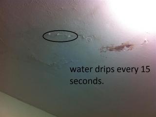

1.Master bed room leak
This leak is round 2 , the first time around the management still under the developer pumped the PU to resolve. Only worked for about a year before round 2 of leaks occurred. The owner from the above unit was delaying and the management office were dumb fools not following up with appropriate actions.
Since I could not take it any longer I decided to pay and look at any options I have to recover the cost. Don't know if it is even possible.

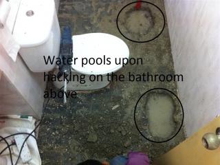

3. Water pooling after hacking
> The damage of water seepage over 8 years.
> No way to resolve if no hacking is done

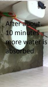

4. Cement absorbing water
The contractor has asked to leave the cement for a day or so that the water will be absorbed by the cement. This should stop the leaks faster.
I will update the post on how long it takes for the water to stop dripping.

From the photo, looks like you only redo the water proofing on the floor and not the wall ? I will say if you want triple safe, you can do double layer of water proofing including 8inch for wall. Then test it for two days and see.

Since you have already gone to the extend of removing the floor tiles, it would be best if you remove at least the bottom rows of the wall tiles & the WC. Seal up any gaps, etc.
Apply water proof membrane including the sides (walls). Test the work and ensure no more leakage before putting back the tiles and WC.
