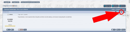

Do you know you can use this to track any thread?
