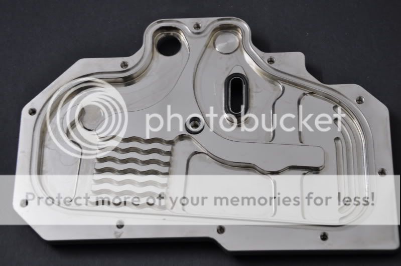

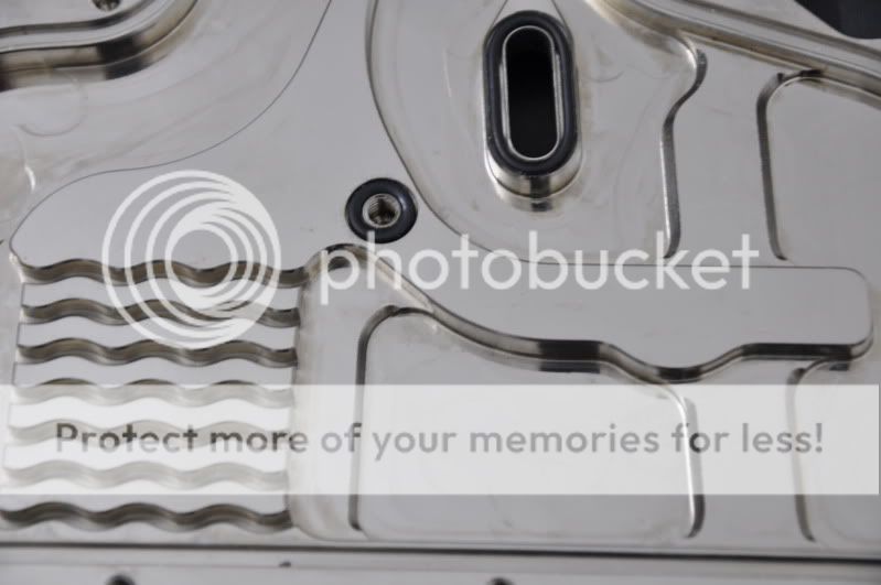

I've opened up my EK FC480GTX Acetal-Nickel block used since May 2010 for my GTX480 & GTX580 SLI:
close up...
All I see is removal stain which can be wipe off with wet cloth, NO corrosion nor erosion at all.

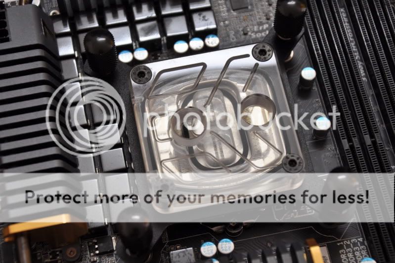

My EK Supreme HF Acetal-Nickel, freshly taken off...
I can see dirt and gunk built by plasticizer of Tygon black R3400 tubing. This plasticizer also build stain on my reservoir tubes - EK Multioption & Bitspower Water Tank-Z.

.... now changed to Plexi top
btw, I'm using distilled water (Giant+Jusco+Carrefour) + Feser anti-corrosion additive.

well technically its nickel peeling off exposing the copper. the colouring is most likely oxidised copper which is brown and some other colour. my main concern is that the nickel plating came off which it shouldnt like my old aqua computer ones which serve me well for nearly a year. these ek i got is less than 5 months old.

QUOTE(kevink82 @ Jun 17 2011, 09:28 AM)
Tat's called erosion, nickel is falling off exposing copper. The brown color can be found at aor cooler base i believe is called a stain due to long term heating.
Aqua & Koolance are way better than EK in terms of nickel plating. I love Koolance for the looks. Damn sexy just that inlet and outlet are separated too far to each other.

QUOTE(iaknesnah @ Jun 17 2011, 01:57 PM)
bro owikh, in other cases the color on the block cud it be only stained..?
Mixed of stain and corroded plate but what i see is more erosion than corrosion. Nickel plate is falling off exposing copper inside.
