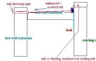

Hi guys, i am come across a thread there that mention resin injection can fix leaking.
Anyone mind to further explain it or can provide opinion whether it will fix my current problem ?
I did toilet/back extension with flat concrete roof by a noob person, it have leaking problem sometime when raining really heavily. however sometime it does not.
I consulted another contractor and he suggest I do awning to cover the concrete roof, somehow i come across this thread and I wonder whether this method will work.
He also told me the problem occur because the contractor do the extension in wrong way.
If there is no solution, it will cost a lot of money and time if Im going to redo/hack it.
He said the contractor do Picture A method, correct method should be Picture B. Last picture show leaking.
Thanks.

resin injection/ pressure grouting not permanent solution,
try this :

QUOTE(skng03 @ Apr 19 2011, 08:08 PM)
try this :

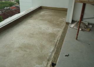

bro, what is gi flashing tuck ?
screed to fall maybe not possible because wall is a bit higher than roof.
concrete kerb is it make thick concrete to cover the joint area ?

it look like this

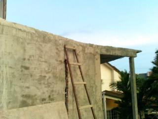

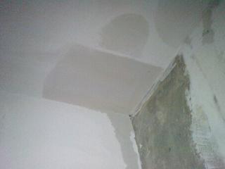

This is a picture of a new rendered cement wall(not painted)...today , there was a heavy downpour of rain..so I thought it is a good idea to check for leaks of flat concrete roof...
I found 2 leaks that are obvious but what about the picture below? the wall looks wet, when I touch it, it feel moist not wet..
any comments? The second is another room with flat concrete roof..and plaster ceiling(not painted)...looks like a leak..

QUOTE(dvinez @ Apr 20 2011, 01:41 PM)
it look like this

QUOTE(jojozep @ Apr 20 2011, 09:44 PM)
for 2nd pic you might see the cracks if you opened up the plaster
but for 1st, it shows to moisture seepage... hard to identify the source.
still as per many above recommended. just built a open roof over it. rather than do another layer of waterproofing without guarantee it will works
This post has been edited by aLittleMisfit: Apr 20 2011, 09:50 PM

QUOTE(aLittleMisfit @ Apr 20 2011, 09:49 PM)

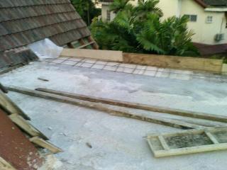

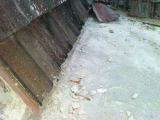

2nd picture for sure, I went up the roof and he cover the gap with a plastic sheet...only...(see below 5th pic with plastic only)
1st picture is moisture seepage, must be here at the concrete roof...(picture 4th) I climb up with ladder yesterday(pic 3) before the rain to take pics and check on THIS contractor's work...cannot trust him liau..
This post has been edited by jojozep: Apr 20 2011, 10:19 PM

QUOTE(jojozep @ Apr 20 2011, 10:08 PM)
hmm.. the work not yet complete. make sure there is gradient so no stagnant waters and it flows fast enough. if less gradient, seepage is common.
it serves no purpose to use good waterproofing cement or material if he doesnt applies it over the vertical wall.

there is no water gutter & sealer. All this job by your contractor is unprofessional.GI flash will not do the job.
