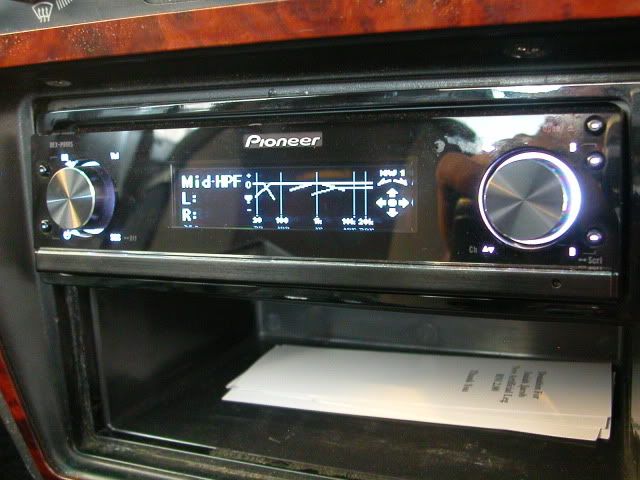

Head Unit : Pioneer P99
Component : Dominations CFS4
Amplifier : Genesis x 2unit
Woofer : Pegasus (later will upgrade to Alpine)
RCA:Tchenovaudio
Speaker Cable : Stealth

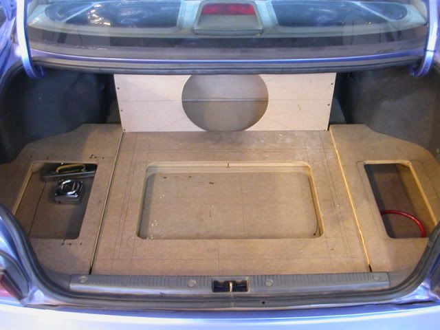

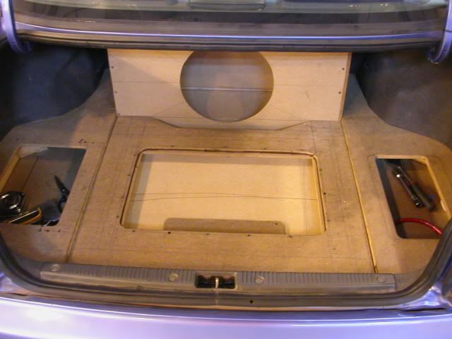

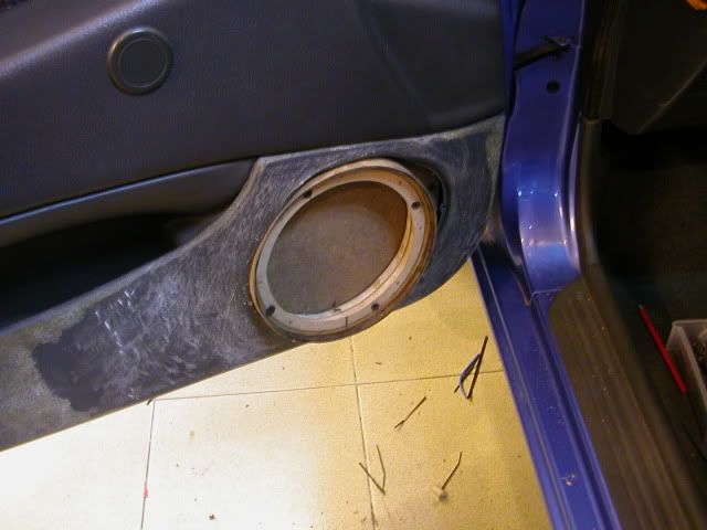

Before modify

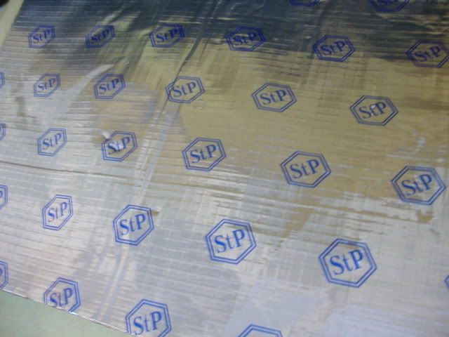

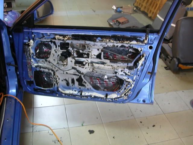

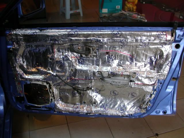

remove out all the useless china soundproof
change it to StP vibroplast (3 layers )

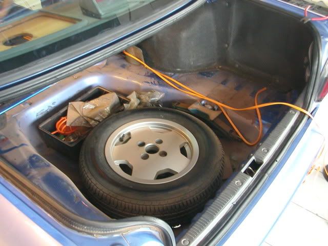

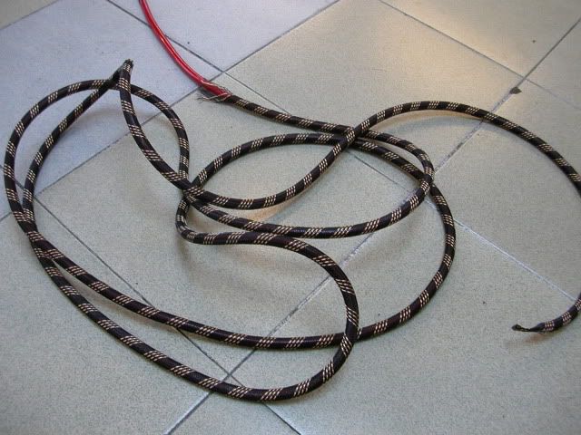

4gauge Power Cable

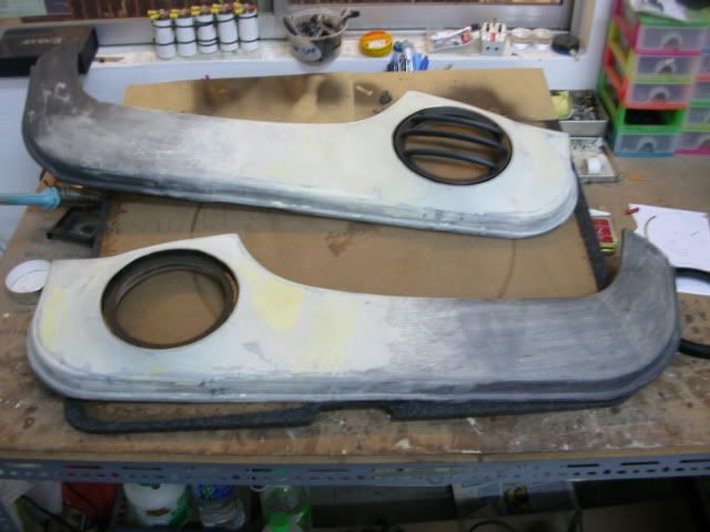

prepare to modify the door panel
door panel modified
kindly reply my topics, then i can share more picture

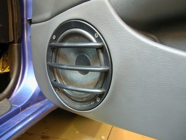

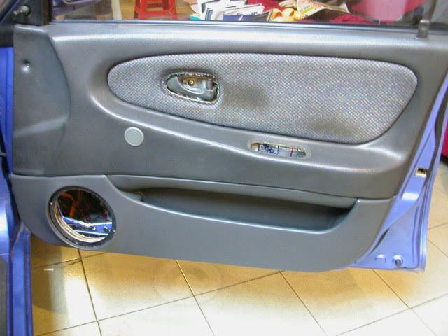

midbass straight away mounted on the plastic door panel?

Looks like it, but I hope not or else the door trim will rattle and really effect the sound from the mid....

actually... to mod that way... behind the mid... mostly will be reinforced by adding a few more layer of mdf till it touches the door metal frame like a cylinder... a lot of grinding and cutting job done... rclxub.gif
from there... screw it down to the metal piece... then there is no rattling or whatever is associated with it... smile.gif
well at least thats how i do it on wira last time... biggrin.gif dunno about TS...

QUOTE(bafukie @ Mar 16 2011, 12:06 PM)
mid bass is mount on the MDF, then the MDF is mount on the on door trim,and it is very solid installation.
you can see MDF is screw with door trim

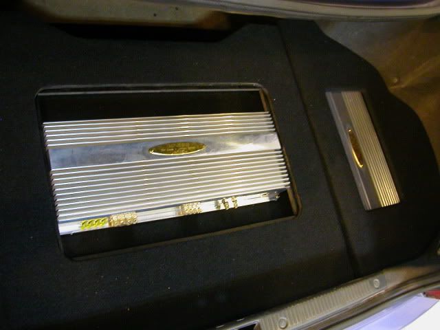

TSmr.wong

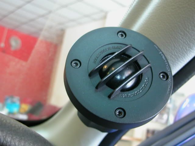

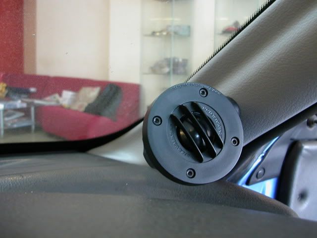

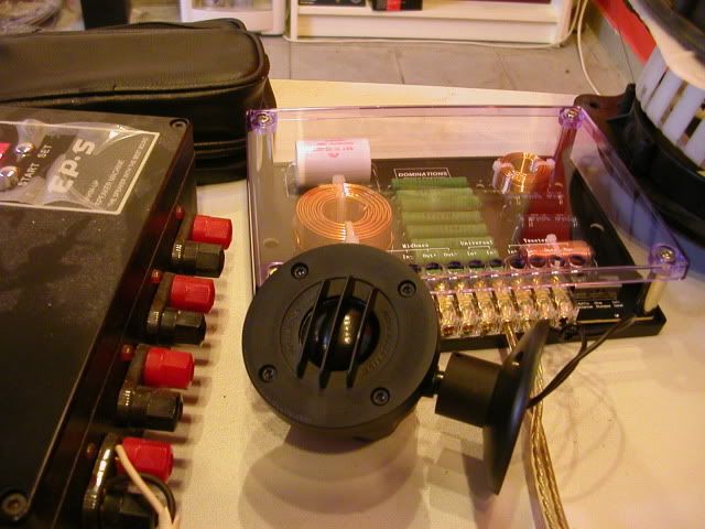

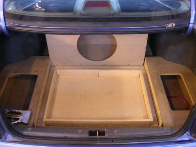

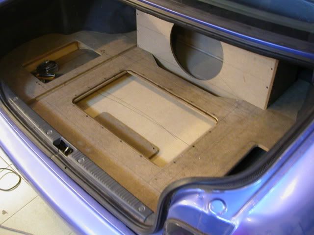

trunk work
kindly reply my topics, then i can show more of picture

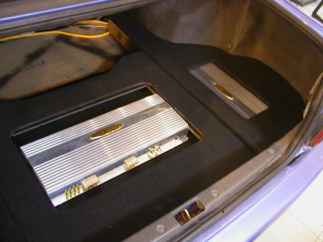

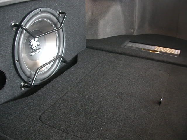

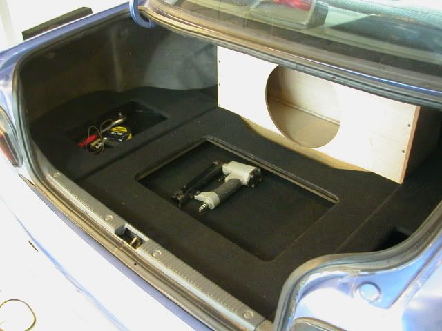

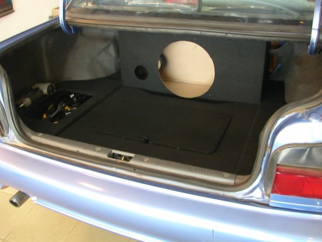

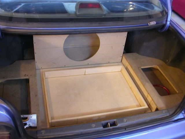

custom made woofer box with 1.4cuft ported
Pioneer P99

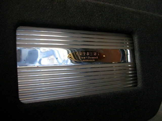

wow。。。。。Genesis Sereis 3 amplifier
temporarily use Pegasus woofer first, later will change to Alpine or Genesis
