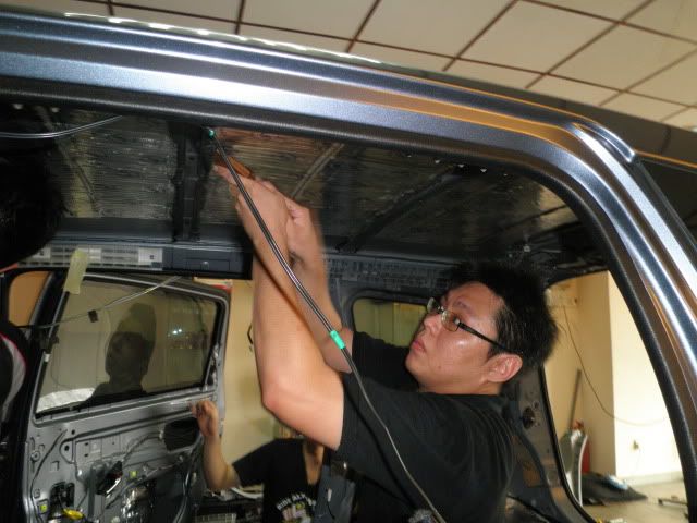

Mr.Dmitriy was explained the door strucure and vibrations caused by mechanical movements.
Explained that where is the noise come from
Use a dry cloths clean the surface
Measure the size of the door
Using the Stp BiMast Bomb to reduce the door vibrations and noise
Pls Kindly reply my topic, so that i can keep on share more pic , thank you

about the door panel, if you have enough budget, better full vibration damping, then add another Contact Damping
Added on March 13, 2011, 8:35 pm
QUOTE(finalazy84 @ Mar 13 2011, 08:12 PM)
so the deadening at only a small part at the door?not the whole door?
StP BiMast Bomb series @ Optimal effect is reached after 40-50%of the square is treated
StP Vibroplast @ Optimal effect is reached after 70-80% of the square is treated
This post has been edited by mr.wong: Mar 13 2011, 08:35 PM

after Vibrations Damping on the roof, add on another Sound Damping
after Vibration Damping, complex with the Sound Damping
