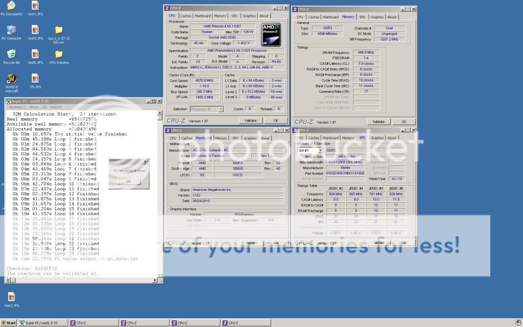

Okie, enough of talking I guess, I will let the screen shots do the talking. Below are the details of my poor test bed:
AMD X3 445 3.1GHz @ X4 B45
Asus M4A88TD-V EVO /USB3
Asus 5770 CuCore @ X-Fire
Seasonic X850

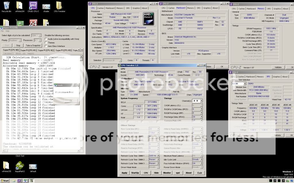

First test, 1600 @ 7-7-7-21-28 with 1.56v, not bad considering the stock timing is @ 11-11-11-30-41 with 1.5v...

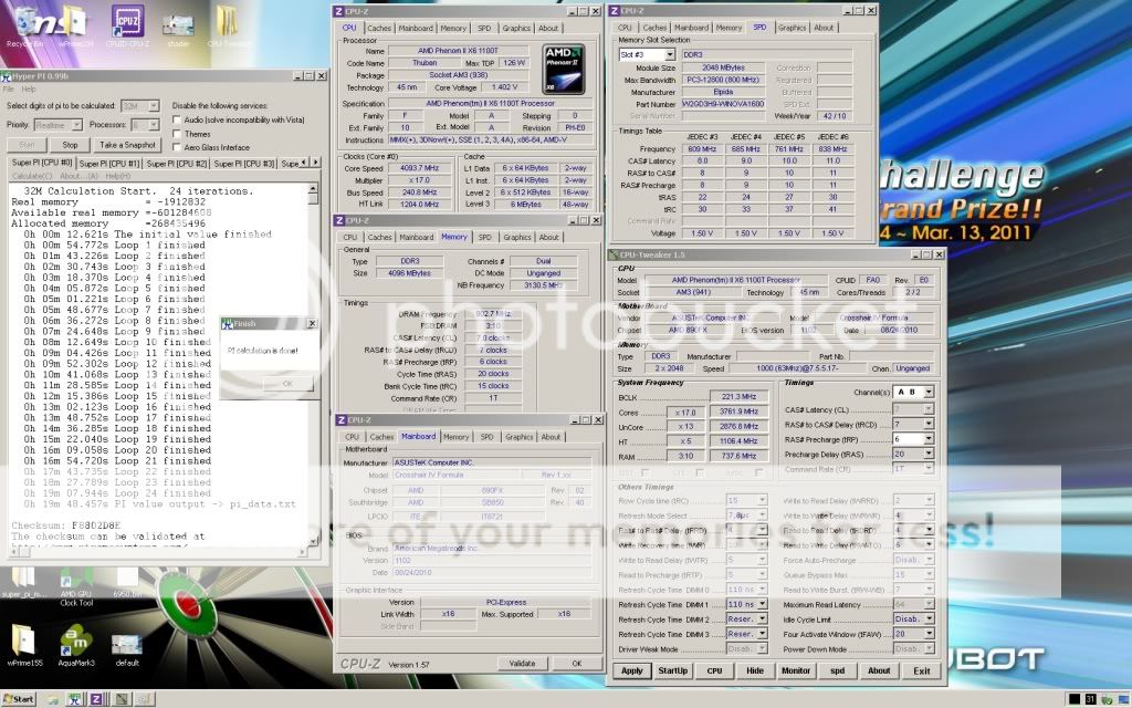

2nd test, 1800 @ 8-8-8-24-32, still with 1.56v... quite decent if u ask me...
Eventhou bein able to do 1800 @ 8-8-8-24-32 can be considered as pretty OK, but i felt that these sticks have something more to offer, hence, timing was tightened a 'lil... Here's 1800 @ 7-8-7-22-29 with 1.65v. Voltage is no longer low enough for low voltage setup but still OK to my book.

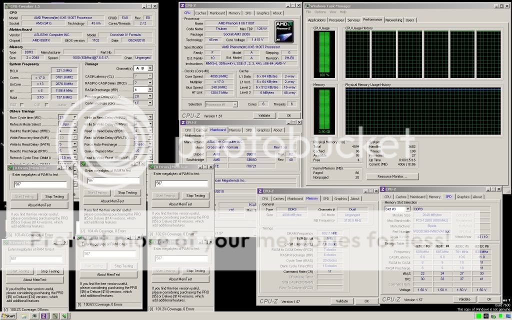

Final attempt, 1900 @ 7-8-7-22-29 with 1.755v. I was kinda surprised this is doable coz i remember back then (when i was using Geil Ultra 2133 CL9, Team Dark LV 1600 CL7 & 2000 CL9 > all using Elpida BBSE chip from what i read) I hit the wall at 1840MHz with same timing.
For those who would like to run their stick with rather high frequency at moderate voltage, these sticks can do 1900 @ 8-9-8 with 1.59v.
*pardon my lazyness for not completing the whole 1 hour test, i was kinda exhausted already... yawn.gif

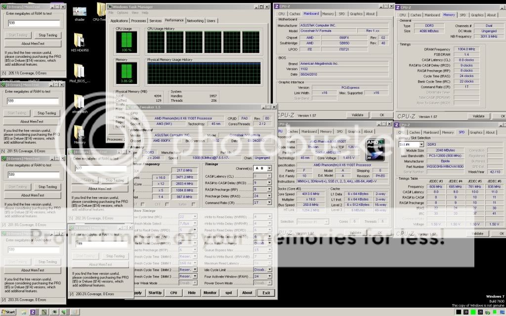

6 horses run at 1600mhz 7-7-6-20
Torture test, 100% burn
Not enough? 200% burn

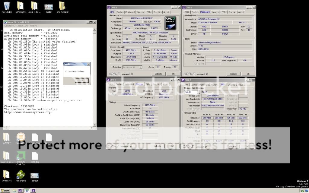

6 horses run at 2000mhz 8-9-8-24 1.65v
Burn test 100%
200%

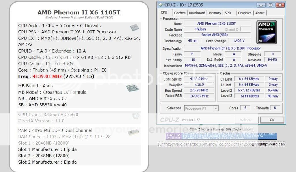

Wonder how high it can go before give up? 2206Mhz.
Validate Image

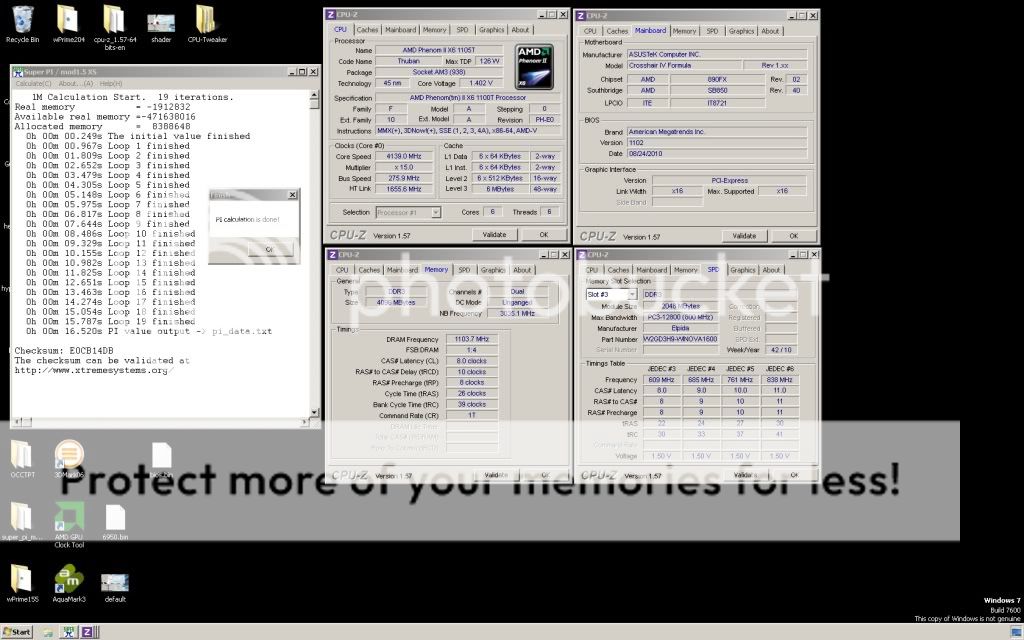

Added on March 16, 2011, 4:11 pmAnother one, drooling?! biggrin.gif
1722Mhz at 7-7-5-16 benchable,
Added on March 16, 2011, 4:55 pmThis one better? hmm
