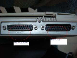

can i know who got canon scanner? model: FB630P
i bought a used canon scanner from LYN member, then yesterday i wan to try to connect to pc, but the cable he give is "to printer" ... not "to pc" ....
then i pm back the seller, "ask him whether got give me wrong cable or not"...
he reply me "im pretty sure the cable is the same,Scanners those days used the same as printer parallel port. "
and i reply him "the cable u give me is through printer only, not through pc"
at the end he reply me "Its thru PC. There's no other cable. In the past, all desktops have that printer port which you can also connect the scanner"
problem now my pc dun have the parallel port, how i gonna test the scanner whether work or not? and as he mention that last time those old pc have the parallel port ... but y the scanner got 2 cable port, 1 is to printer another to pc??
actually is it when u buy this scanner .. it will come by 2 cable? 1 is "to printer" cable , and another is "to pc" cable?
or just only 1 cable as he mention?

you are right. that is the pass thru
probably you will need this
http://www.mudah.my/Canon+CanoScan+FB630P+...ner-8556731.htm
it is a usb-parallel cable. make sure u buy the one with female output like this one http://www.lelong.com.my/vztec-usb-paralle...0-10-Sale-P.htm
probably its not worth it. just get urself another printer-scanner combo.

You can install a parallel port PCI card into your pc ...

If you don't have the parallel port cable connected from scanner to pc then you have to get one
In old days all printer (dot matrix) are using parallel port.
Since pc only having ONE parallel port, the two connectors (to pc and to printer) allow you to connect printer to the scanner ....

problem now totally the cable cannot plug into the "pc slot" there... just only can plug into "printer" there.... how to consider just only 1 cable when u purchase a scanner....
