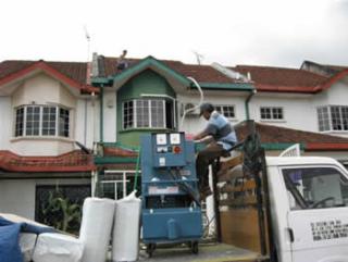

i think TCL is the only one for cellulose unless someone else is doing it now too. they are pretty good. if you can afford it i suggest you do both - cellulose insulation for the ceiling and coolbat or similar foil for the roof. in combination you'll have a great reduction of heat for the house. i did it and this allows me to AC the entire house for around 0,15 KWh per month and sqft.

ozak,
since its blown into the space to form a uniform layer i'd say most likely yes. but it will depend on the actual layout of the space in question. you could check with TCL and request a site visit.
philipcs,
i think i paid somewhere around 2,XX per sqft for the cellulose. the foil i bought from a hardware store and got installed when my contractor took down the roof and reenforced trusses etc. so i got the installation FOC. if the roof is in place you can most likely install it from inside the roof but you might have a hard time to cover the entire roof properly. the trick is basically to cover all the way because then you create a barrier for the hot air and when you have openings at both sides the natural draft (and whatever wind you may have) will help to continously carry out hot air before it gets into you actual roof. so the cellulose has less heat to shield of. also you should not cover the cellulose so air can circulate and transport heat (and moisture - beware of the dew point!) away.

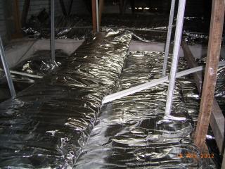

coolbatt maybe a good product ... but their installer has no idea of how insulation work... t
Added on May 20, 2012, 7:31 amtry TCL ... their installation method is better ...

TCL is better in my view... b'cos Coolbatt is difficult to install.... like the photo...

QUOTE(manemaren @ May 23 2012, 04:32 PM)
I'm confuse also...but the photos below are from TCL website...and the installation is much more difficult inclusing removing rooftop.

TCL end result is better.... Coolbatt only effective on a empty ceiling... the one without electrical wire or water pipe running here and there...
The earlier photo is my house actually... no effect at all... waste of money
I am considering taking it out...
Is actually nightmare for pipe and electrical maintenance. Also for house owner using light bulbs with ballast. And if house pipe or roof got leaking, can growth mushroom :-) .
I ask similar vendor before of the points above. Can never give me satisfied answer.
