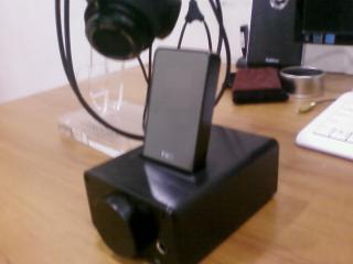

So this is it, after weeks of waiting, the Fiio E9 has finally landed on my desktop.
1st impression? Solid built. Nice metallic surface with no sharp edges on the side, something u don't expect from the Mainland manufacturer. But hack, who cares about the cosmetic, we are after all, an audiophile, not art collector.
Ok, let's start with the bad. The bass boost function is practically gone once you mount E7 on E9. Yes, you can still use the bass boost, but not when you mount it on E9 (ie: use E7 as DAC and connect to E9 via 3.5mm cable). But why must I go through the additional step?? E7 as pre-amp and E9 and power amp is, in my own opinion, the best concept Fiio has ever came up with. The lack of bass boost has spoil the otherwise perfect combination. On a side note, I've tried the 3.5mm connection method and notice no loss of SQ comparing to the docked E7, but it is eating too much of my desktop space.
Bass: Sigh. To be honest, bass is the least noticeable enhancement that E9 has to offer. Maybe it's due to the lack of E7's bass boost function. Anyway E9's bass is on par with E7's at SQ0 level, most likely because of DAC work is handled by E7 anyway.
Mid/High: Here's where E9 shines. E7 alone is already a great DAC that's capable of bring out the musicality from the tunes. Hence, by docking it to E9, the signal will then skips the rather puny amp in E7 and get power up in E9. By the way of description, one can easily imagine E9 (with E7 docking) is like E7 after steroid, metaphor. The additional hint of added warmth is what I like most about the E7 + E9 combo. All in all, the mids are very clean and pleasant and the highs are detailed and not over analyzed.
Ok, above is my 1st 30 mins of review on E9. It's a shame that I only have a pair of MS1i to test with, I heard this baby has enough juice to power up HD650. Any proud owner of HD650 is willing to loan me their baby for testing? brows.gif brows.gif

Some pictures taken from my mediocre handphone.
