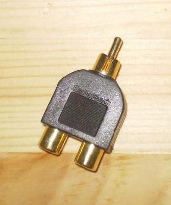

guys, can i hook up 2 subwoofer to 1 amp with only 1 sub preout? issit must use something call Y adaptor or something? can some one post a picture of it?

yes
wait, this looks more like a Y

Can. By using this :
For more info :
http://www.lelong.com.my/Auc/List/2005-01D...e-RCA-Plugs.htm

Yes by using Y-spliter.Why do you want to using twin sub..1 sub still not enough meh hmm.gif
