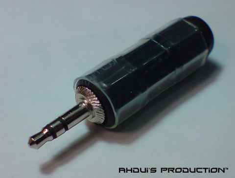

I've just tested 75 ohm impedance adapter for a few days.
Test subject:
phone - silver bullet, piano forte II
amp - 3move
The observation:
-Slight addition in bass department. Both silver bullet & piano forte II is not a bass phone, so its ok.
The price to pay for these: clipping the other part very much, high, middle, you name it. Sound very weird. Don't like it shocking.gif
Lesson I've learned:
-Dynamic and 75 ohm impedance adapter not good paired. 75 ohm is high. May be good if choose lower impedance? Don't know. maybe yes. hmm.gif
-Do not pair with bass phone, the bass will become too overwhelming (tunertoobe)
-75 ohm is good with high clarity BA IEM, originally intended for er4p.

impedance adapter, you meant this?
i've tried looking for it before, no luck so far.
i need it to control gain output for low impedance headphone when paired with amp, such as tubey. any place i could get this? hmm.gif

yupp, more or less the same plug. Got mine from ebay. Locally, you can order from more2teayap.
Iqbal_kakashi

hm3 made a good pair with 39 ohm impedance adapter. thumbup.gif cool.gif 75 ohm is no good.
