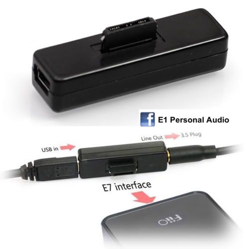

QUOTE(terradrive @ Feb 5 2010, 06:08 PM)
it would be even better if they put line-out instead of dual headphone outs  doh.gif
Line-out has been moved to the dock connector. I asked James @ FiiO and their concern is that people connecting their headphone to the line-out to "try it out" which could possibly damage their headphone and even worst, their hearing. They have many non-audiophiles customers so the decision is made not to risk any chance. There could be a cradle (with line-out jack) released later if enough interest has been shown, or else the line-out will be left to the upcoming E9.
