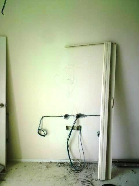

Just started reno last week , was informed that my contractor HACKED 2 shear/main wall that should be hacked!!
Need to stop renovation work and ask the reno guy to seal back the wall and then only can continue reno .
Was shocked and try to regain composure, asked them back the details of the illegal hacking.
They didnt manage to give the exact answer, which wall and what problem ...WTF..so I called back my reno guy and ask for info.
Found out from reno guy the following :
-the hacking was for plug/switch repositioning
-its just a small hacking which dont fall into hacking category, so wont kacau the shear wall
-prior to this already asked the management office(unfortunately no written) on how to do , and they advice ONLY can do for plug reposition and nothing else
-he will snap a pic and shw to me the work
Waited few minutes...and he send me the pic ..

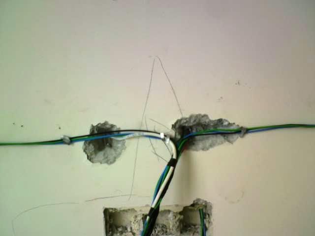

The above 2 hole is new ...the underneath is original one

Normally its not advisable to hack shearwall. It may affect the strength of the wall. Even if its just for plugs as it reduces the concrete cover protecting steel.
Just because there's power points on shearwall doesn't mean it can be hacked because the construction sequence is to lay conduit for those power points BEFORE concreting take place.

yes vreis is right that electrical conduits should be layed prior to concreting .... any hacking on the shearwall which is the main structure the building should be avoided ... if need to hack then only small hacking is permitted and should be concreted back again with high grade grout ... covering it with cement is not enough ... thats my advice from an engineer perspective

Its better not to hack any of shearwall as it acts as column & beams supporting the whole freaking building. Maybe its a bit exaggerating, but you'll never know how it'll affects the wall.
