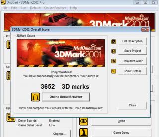

3d mark 2001

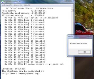

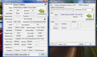

here some screen shot after 11% overclock
** im using cagiva single blade Notebook cooler for cool down my laptop temp
Processor Amd turion 64x2 TL-58 2109.1 mhz (original 1900 mhz)

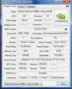

Gpu nvidia gforce 7000m/610n 450mhz/650mhz(original 350mhz/0mhz)
change Bus speed to 222mhz (original 200mhz)
Oc processor 11%
ram
IGP/GPU
change core clock to 450mhz
change memory clock 650mhz
oc 28%
i will update 3dmark after this!!
