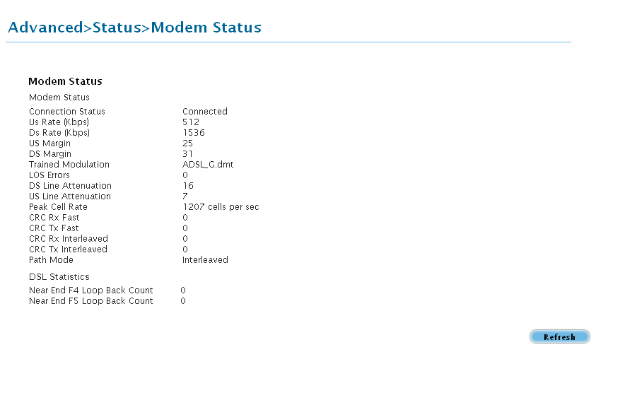

login the modem, search for DSL/Modem status for Margin & Line Attneuation, something like this » Click to show Spoiler - click again to hide... « post yr print screen here

QUOTE(K for Ketamine @ Mar 13 2009, 05:43 AM) login the modem, search for DSL/Modem status for Margin & Line Attneuation, something like this » Click to show Spoiler - click again to hide... « post yr print screen here  pass already have. login cant find for margin and line attneuation thingy. no other related thing too. btw using riger db102 modem. makes me feel like buying new 1 zz but i duno the problem. Added on March 13, 2009, 8:09 pmhere's my dsl parameter. » Click to show Spoiler - click again to hide... « Vendor ID: 00B5GSPN Revision Number: E.37.5.49 Serial Number: 123456789abcdx Local Tx Power: 12.1 dB Remote Tx Power: 15.3 dB Local Line Atten.: 52.0 dB Remote Line Atten.: 31.5 dB Local SNR Margin: 14.0 dB Remote SNR Margin: 16.0 dB Self Test: Passed DSL Standard: G.dmt Profile: MII Tx Line Rate: 512 Kbps Rx Line Rate: 1024 Kbps Framing Structure: Framing-3 Trellis Coding: Enable Power Management Mode: L2, L3 Not Allowed

QUOTE(_CheeZ_ @ Mar 13 2009, 07:08 PM) pass already have. login cant find for margin and line attneuation thingy. no other related thing too. btw using riger db102 modem. makes me feel like buying new 1 zz but i duno the problem. Added on March 13, 2009, 8:09 pmhere's my dsl parameter. » Click to show Spoiler - click again to hide... « Vendor ID: 00B5GSPN Revision Number: E.37.5.49 Serial Number: 123456789abcdx Local Tx Power: 12.1 dB Remote Tx Power: 15.3 dB Local Line Atten.: 52.0 dB Remote Line Atten.: 31.5 dB Local SNR Margin: 14.0 dB Remote SNR Margin: 16.0 dB Self Test: Passed DSL Standard: G.dmt Profile: MII Tx Line Rate: 512 Kbps Rx Line Rate: 1024 Kbps Framing Structure: Framing-3 Trellis Coding: Enable Power Management Mode: L2, L3 Not Allowed consider bad, ur SNR 14-16dB.. need at least 23dB for no dc(based on my connection).. sure dc dc n dc... like mine lol... u staying at wic part of klang?
