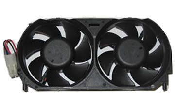

tot31
post Jan 22 2009, 11:11 PM
I DON'T GIVE A DAMN
2,451 posts
From: GOD's Land
I'm going to use this user posted image..got it from my dead x360...
