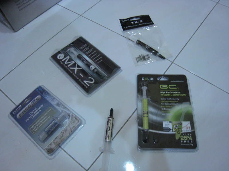

In this review, i will be comparing the commonly found thermal pastes from our friendly garage sales and our IT stores. There will be 5 candidates for this test and they are Arctic Cooling MX-2, Arctic Silver 5, Tuniq TX-2, Gelid GC1, Ocz Freeze

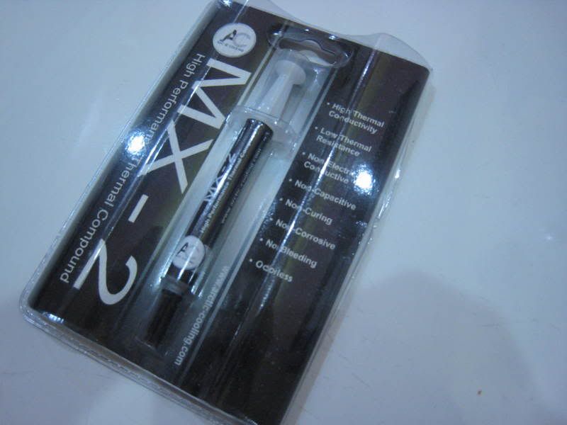

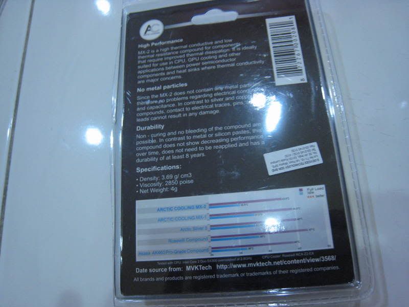

This is the famous Arctic Cooling MX-2. It comes in a 4 grams package and is said to be better than the Arctic Silver 5 by 2c according to the box.

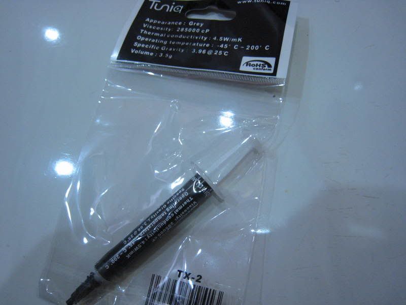

OK, this one is the common Tuniq TX-2 that most of the forummer here uses it cos its cheap and performs well lol. This TIM comes in a very simple packaging and have a content of 3.5grams. Due to the simple packaging, sometimes there are cases where buyers who uses postage receiving that TIM "divided by zero" when it reaches them

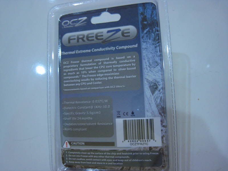

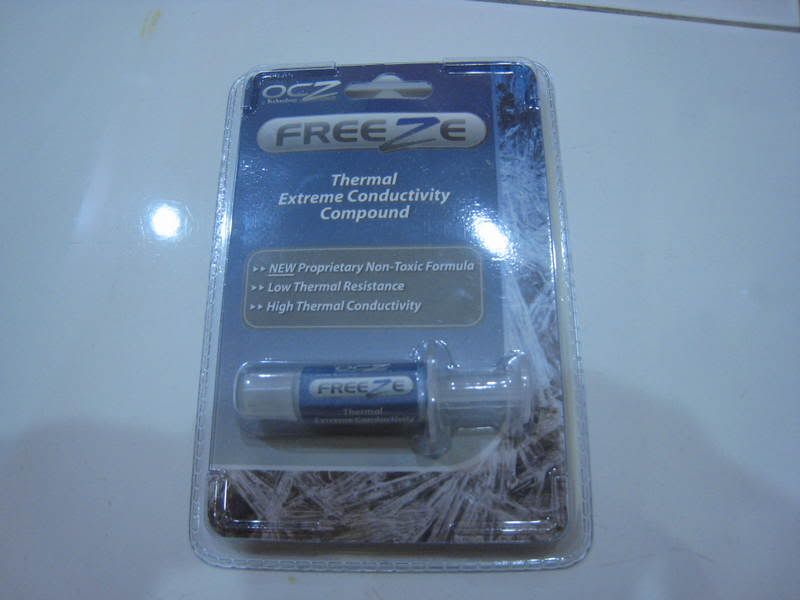

This iz are our last candidate Ocz Freeze. Dubbed as the best TIM by benchmarkreviews.com. It comes in a 3.5gram package just like the Tuniq TX-2 but it has a shelf life of 24months stated on the box. The rest of the TIMs have no indication of shelf life available on the box.

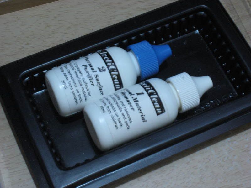

ARCTIC CLEANER IS USED FOR CLEANING THE THERMAL PASTE

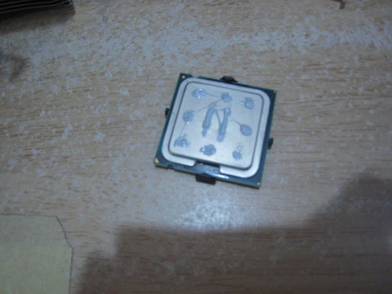

THERMAL PASTE APPLICATION
