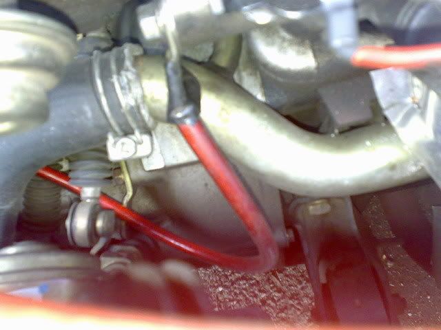

Currently I drive Pronton Wira 1.5 Year 2005. I would like to know the way how to increase performace.
Isn't got some additional stuff or component to increase the car horse power performace?
Got any way to modify engine or gear box to increase the car horse power performace?
Please inform the shop name, address and telephone (in Johore area)
Please introduce and advise to me........... thanks
Please refer to my car engine photo as your reference.
1) original engine and gear box
2) add E-Power for stabil voltage of spark plug
3) Micro Compresor
4) Simota open pod air filter
5) Normal brand of spark plug cable
6) NGK G-Power spark plug
7) 4-2-1 type extractor, normal brand of midbox, Exhaust piping 1.7" & s-flow type muffler
[attachmentid=667520]

EFI engine? u should have refrain yourself from the above mods earlier and save money to buy unichip. port & polish the head and side gap & index a normal spark plug instead of going for expensive plugs.
Open pod filter stuck inside a heated engine bay perform worst than the stock air filter.

get from halfcut shop... complete set with flywheel, clutch plate and clutch cover.... check clutch plate condition... if wears out alot adi better buy new one... clutch 1.6...
why supertouring flywheel and not other 1.6 flywheel??... because original proton 1.3/1.5 flywheel has 5 bolts securing the flywheel at the centre... proton 1.6 flywheel has 6 bolts, wont fit 1.3/1.5 engine...
but mitsubishi supertouring's flywheel has 5 bolts and the size of a 1.6 flywheel... hence, u can use 1.6 clutch plate for better grip and acceleration...
remember to skim/lightened ur ST flywheel coz it is heavier compare to ur oem flywheel... skim how much depends on whether u looking for pickup or topspeed....
1.3/1.5 oem flywheel
ST flywheel
1.6 oem flywheel

umm..how to see svdo engine or not ah??i dunno leh..got write down at the engine big big like DHOC like tat ah??or got to check there and here to see is svdo ah??
4g15 mmc ecu engine...
4g15 siemens vdo engine..

QUOTE(soyaben86 @ Nov 20 2008, 06:42 PM)
yup yup..thanks for the photo..i will check with my friend if he is coming later.. laugh.gif
(can show off a bit cool2.gif )

u circle the thing there ma..so if got that thing meas is not vdo engine rite??or u prank me cry.gif

QUOTE(soyaben86 @ Nov 20 2008, 10:50 PM)
lolz... dat one not i circle also... i googled da photo one mah....
da circled part is fuel hose... both svdo and mmc also got lah...

cheh..i thought u so good go circle that thing and ask me go check see got that thing or not..
then how to see lar?? laugh.gif i wanna show off lar..wanna prove to my friend that forum can learn thing also.. cool2.gif

QUOTE(soyaben86 @ Nov 20 2008, 11:04 PM)
if wanna learn anywhere also can learn...
da difference is at the throttle body... mmc can control the ISC.... svdo cannot...

QUOTE(evangelion @ Nov 11 2008, 07:36 PM)
3) Micro Compresor

mythology i heard not bad... as it comes with damper....
ignition earth diy can adi la... no need buy branded expensive cable... i diy mine using 4awg cable... connect from engine bulk head to battery negative terminal... so far so good.... very minimal difference.... haha...
Can you show your photo to me? which position of engine bulk head?

where to buy 4awg cable? how much?
u can mount it to the distributor bolt... this improves engine head grounding... which is important to produce strong steady spark from sparkplug....

QUOTE
4awg cable can get from electronics shop....
bro catabomb. can show far a bit pic ahh. cuz i not really sure.
easy to DIY? got a thread of DIY this thing?

QUOTE(the_catacombs @ Mar 3 2009, 02:05 AM)
no problem...
recommended to get super touring flywheel and 1.6 clutch plate + cover set... FYI, wira 1.6 flywheel cannot fit into 4g13/4g15...
benefit of using bigger flywheel allows u to use bigger clutch plate... a larger surface allows better friction... it is recommended to lightened ur supertouring flywheel around 500-600g....
Hi bro, how to lighten the flywheel? Or is there anywhere we could buy it?
the_catacombs
post Mar 6 2009, 01:23 AM
8 stars wooo....
10,975 posts
From: disini disana
QUOTE(josh2104 @ Mar 4 2009, 10:53 AM)
Anyone able to provide an answer for my question... ?
I kinda need it as fast as possible ~
what was ur question??....
QUOTE(bizzy @ Mar 6 2009, 12:02 AM)
well why no1 recommended on using Racing cluth exedy on 4g13p? or 4g15p ?
is more better rite den the super touringclutch rite?
racing clutch has its pros and cons compare to ST flywheel and 1.6 clutch.... clucth material is different... means it can withstand tougher punishing without losing its grip so fast... meanwhile 1.6clutch only offers a bigger friction surface, hence better grip during acceleration....
best option IMO, get ST flywheel and use 1.6 4-puck exedy racing clutch.... icon_idea.gif
DIY ignition earth cable...
