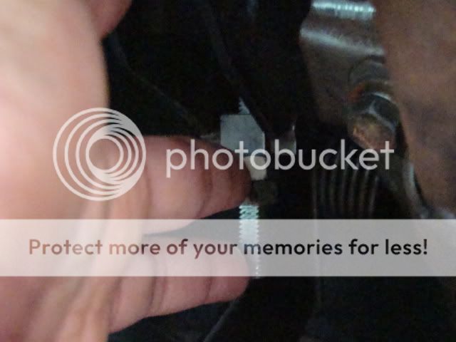

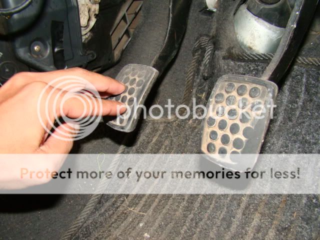

before anything, can u check the free travel of clutch paddle. should be about 10mm to 30 mm. adjust with 12mm wrench. user posted image
