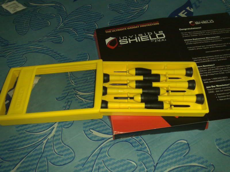

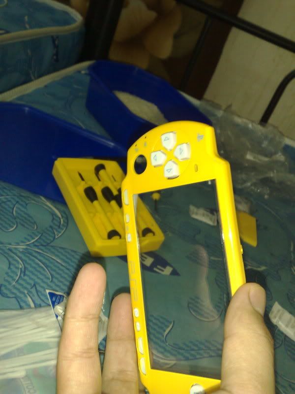

guide!!!!! how to fix psp water damage.(start.select.volume.display.home button SCREWED!)
[COLOR=red]
1st-u need philips scrwdriver size 00 @ 0
2nd step-remove faceplate.(remember.plz do in the free dust room.or switch off ur fan.)at least as i do.

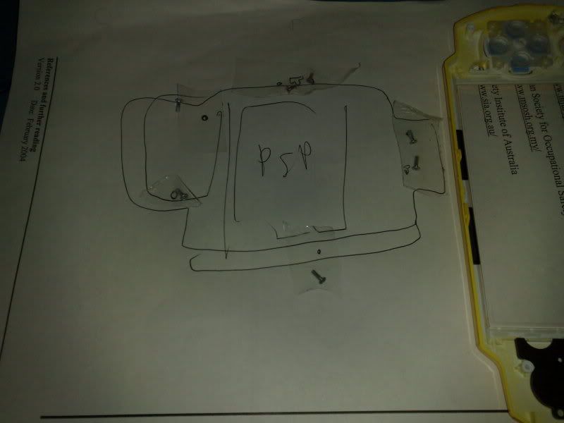

3step-do a sketch of ur psp.and tape ur skru.(this thing avoid u miss part ur skru after u want to assemble ur psp.

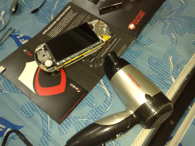

4step-u need a working hairdryer.

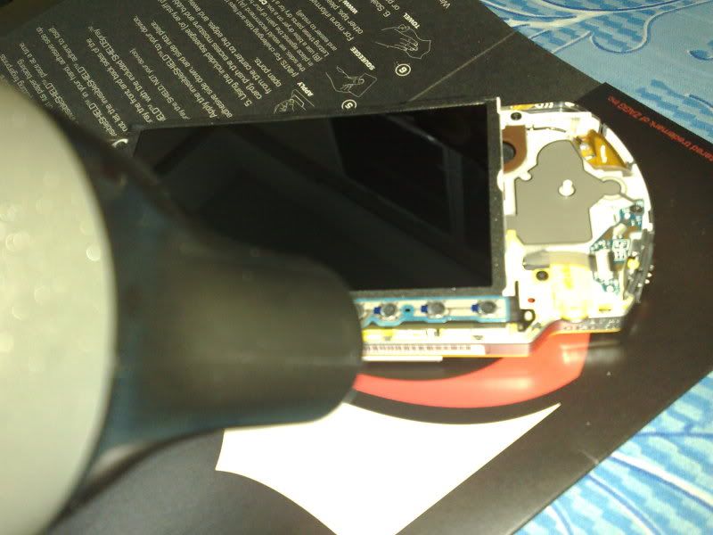

5step-blow the inside with a hairdryer.
using hot air.

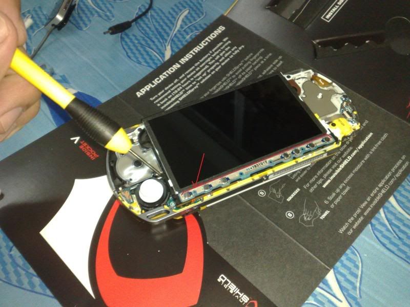

6step-remove the salotape who tapped at ur menu bar.(look to the red arrow)its quite easy actually. but u must be careful.use a needle to open it up.blow the tape and if necessary.rub menu bar with a cotton bud.until u feel satisfied.
then tape it back.

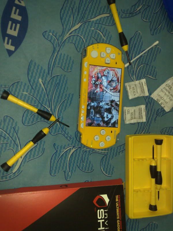

7-step.put battery into ur psp.and try switching it on. press the menu bar with a cotton bud.if not work.repeat step-5
8-assemble ur psp.
9-done!!!!
although my english is not very good.i hope u will understand what i want to say and hope it do help those who counter the same problem as me.
peace for all.
by hanissyazwan

Btw,your psp sketch is good looking rofl

yeah yeah true true.... but it's a good idea to newbie too.... great way to memorize what goes in where.....
I learn this from a comic also.... since now everyone have a camera phone.... take picture of each dismantling stage.... it will help when u put it back.... then later can post up here too....
