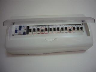

Hi all...I post this here since this is the closest section for Home stuff...
Need help from all Si Fus here..recently an electrical applicance short circuit and caused two of the fuse in the fuse box to be tripped permanently. (Can't push it back up) So now the some of the switches cannot be used. :(
So the questions are:
1. Can I replace the faulty fuse individually?
2. How much does it cost?
3. Advisable for my to DIY the replacement? (I will pull down the main fuse switch. Is there still danger?)
4. Anything that I should take note when shopping for a replacement?
Thanks in advance guys!

not recommended to DIY..coz u are playing with high voltage and current..at your own risk..
replace the fuse..cost u ard RM10 to RM40..depends on model,brand and ampere..

I use to change it myself three to four times already.
Sometimes, it is those cheapo brand of circuit breaker spoilt on itself.
1. Yes, If you know how to dismantle the switch box. But look at below warning.
2. A few ten RM, depended on brand, Hager is the most expensive, so does its better quality. Other brand don't quite familiar with.
3. No advisable, only for those knows how it works and know electrical stuff.
4. Remember to check the Ampere rating, There are different circuit breaker carry different amp rating, when buy time, check the Ampere rating.
WARNING: Those wire inside can be messy depended how wiring done previously. IF YOU DO NOT KNOW electrical stuff, and have no idea how electricity work, better hire a wireman to do it for you, labour cost won't be too costly, depended on location wise.
WARNING again, you can get electrical shock if you don't cut off the main supply from outside of your house as even you switch off the on/off switch of the panel, you still get one LIVE wire, if mistaken touch it, you can be FATAL electrical shot because it carries high AMP.
It is advisable to get a wireman do it for you. As if you knows in the first place, you won't post up to ask either. No offence.

The situation has been settled. Fyi, it's called a miniature circuit breaker (MCB). Always check the rating. Make sure it's the same. Normally written C20, C10, C6... DO NOT in any circumstances, touch the LIFE cable. U might want to tape the conductor in the LIFE cable 1st.

I saw the electrician fixed for me...like damn easy...but still takut la if want to fix my self...no confidence...haha..
actually need to get back the same MCB (In my case it was C20 that was faulty) , take off the white plastic covering the row of MCB..unscrew the top and bottom part (you can see 1 row of screws at the top and bottom)..then only can pull out the faulty MCB...but like what everyone advice...DO NOT attempt to DIY if you are not sure what you're doing...this is life and death matter.. smile.gif The electrician only charged me RM80 for 2 MCB plus labour.
