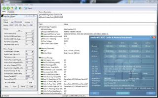

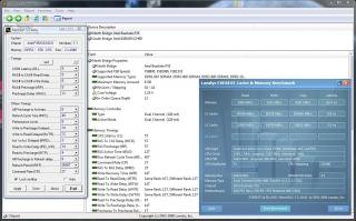

i have two result of O/C
Is it the tRTR and tWTW problem?Beside that, all other things are same except "DIMM1 Clock Fine Delay" and "DIMM3 Clock Fine Delay"... but oc to DDR2 900 or above will become very slow, i have tried many times
My motherbroad don't have these two settings...(tRTR,tWTW)
However I think that caused this problem is not relate tRTR and tWTW.
just have below
on the other hand, some people my motherbroad problem...
someone say MSI neo2 have problem , just like jumper settings or relate to BIOS version.... but i still can't find the problem....

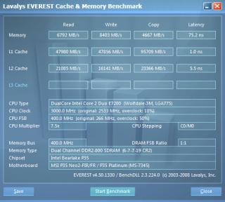

i try many times, as you see, the L1 and L2 cache are normal, just memory speed very abnormal...
surely something is wrong, but just don't know what and where...

i have newest result benchmark
If I run 5:6
fsb 430
cpu DDR2 1032... seems have no problem at all
QUOTE(cracksys @ Jun 24 2008, 04:38 AM)
so, you oc-ed RAM by increasing its speed only ? how about other timing, automated ?
below are results same all have problem....
DDR2 900, if i set below DDR2 900.. no problem at all

I am using MSI neo2-FP P35, there is a jumper has o/c setting~
266Mhz , 333Mhz and 200Mhz, default, the MB jumper set to 200Mhz, i need to set it to 333Mhz, i don't know why, just someone tells me~
than the tRTR tWTW tRTW tWTR will auto increase lower T as you can see the newest result and the image post in #1 do a comparison.
