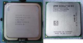

This is a whole CPU : Intel E2160 (left), AMD64 X2 4200+ (right)
Each CPU has an IHS on top of it. The IHS is the flat metal piece that has all the wordings written on it.
The picture below shows a pentium 3 without the IHS (left picture) and with the IHS (right picture).

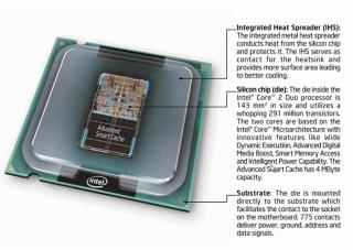

Inside each CPU, is the die (or chip which contains all the silicon integrated circuit) - can be seen on the above left picture
The die lies on a "substrate", which makes up the whole chip (above picture, green color material)
See this picture of a dual-core for a clearer understanding.
From the above picture, you can also see 2 cores (Core0 and Core1) and an "advanced smart cache" region. These all make up the die of the CPU.

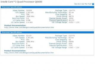

See this example below:
This data shows two steppings of Intel Q6600 - an older "B3" stepping and a newer "G0" stepping
If you look at their thermal specification:
B3 - 62.2'c
G0 - 71'c
For non-overclockers, they are very not important.
However, for overclockers, apparently, the higher the thermal specification, the better it is for overclocking.
These are a few advantages of having a higher thermal specification (which may include other factors like newer steppings/fixed bugs)
1) Uses less power and dissipate less heat
--- at idle (as it dissipate less heat at C1E state)
--- at load
--- when overclocked
2) Runs cooler due to the above
3) Better overclocking capabilities (in general) - as heat is the number 1 enemy for overclockers
You can read more about different stepping/thermal specification here:
Anandtech : Q6600 G0 vs B3
So now you know why everybody is scrambling for a Q6600 "G0" stepping.... smile.gif

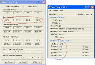

Here's a good example of different software giving different Tjunctions for my Q6600. See the picture below
Realtemp's Q6600 Tjunction is 95'c
Coretemp's Q6600 Tjunction is 100'c
Because of that, the temperature readings of realtemp is 5'c lower then coretemp's readings.
You can read more about it here : Accurate temperature reading - the problems (Anandtech)

So, if you look at my Q6600 "Delta to Tjunction", I'm quite far from my maximum core temperature, so I'm quite "safe".
Note : Alternatively, you can use realtemp, which shows you the "Distance to TJMax" which has the same functions.

Type of CPU
This is obvious as different CPU would have different thermal specification.
For example, take a Q6600's thermal specification (TcaseMax):
Q6600 B3 stepping: 62.2'c
Q6600 GO stepping: 71'c
Obviously, if both processors were running at a TcaseMax of 60'c, definitely the B3 will be the more "tortured" of the two CPUs!
And I guess it would be also true for mobile & server CPUs which are more reliable and can take higher temperatures....

> Remove the IHS - not for the average users, more for extreme overclockers (as removing the IHS will void the warranty)
--- By removing the IHS, the CPU heatsink and come in direct contact with the CPU die/chip. This will cause a significant drop in core temperature....
