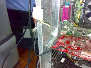

The volmod area, I only focused on Vcore, the wire is for Vcore measure...
...and this is the other end of the wire, for easier measuement so I don't short things up like last time

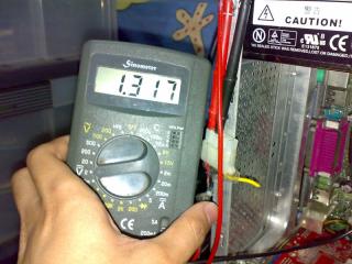

What you see is what you get. The actual voltage after voltmod, forgot to take the stock Vcore shots (stock is at 1.225V)
Any improvement in overclocking? With stock Vcore, it only manages paltry 20MHz overclock from stock 500MHz. Now it reaches more exciting +100MHz overclock, the only problem is the temperature. 60C load on 9600XT is very hot, so I kept it at 580MHz when playing games (load is 56C)
