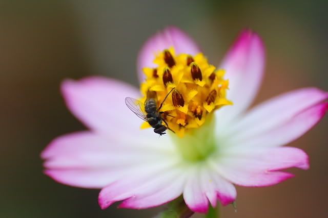

i like the ring and also the yellow flower so much. what camera are you using? and also lens?
