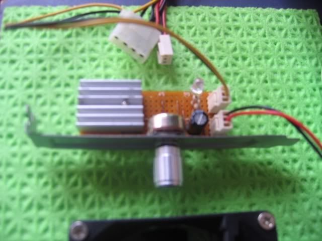

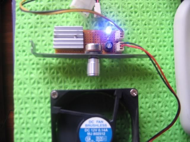

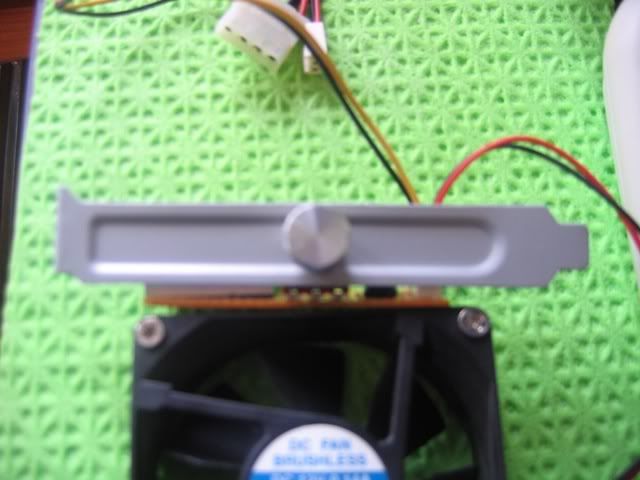

Dudes..
kinda fun doing it, however I'm unable to provide any work logs coz i malas take pictures while doing it,
anyway it was a simple project only and a few has done it also..
here are some pictures for you diy modders out there..
TSzeuser
post Nov 30 2007, 04:33 PM
53 posts
Joined: Mar 2005
From: The darkside of the moon
http://img306.imageshack.us/my.php?image=schematic4he.png

wats the max ampere the controller can take?
TSzeuser
post Nov 30 2007, 04:57 PM
53 posts
Joined: Mar 2005
well, not quite sure bout that, tested on 12v 0.32A, and the fan works fine, the fan wont go full speed at any rating coz using LM317 doesn't give exact 12v output, u'll get ~ 95% of the speed.

LM317 is 1.5A.. if u dont exceed, it should work fine.. anyway, RM40, u earn quite a lot wor.. haha..
u might wanna consider active cooling as well for the LM317 cause it can get very hot when u load it @ around 1A..

U r absolutely right about the the LM317, thanx for commenting, i was also not sure exactly, just followed the diagram, electronics newbie here.. rclxms.gif

ur circuit looks very nice simple... but i notice that the pcb solder side is a bit higher than the slot area.. and wil come to contact with pci slot areas components... not a problem if its insulated .. ut just to point out to u

about the clearence, i suppose if i put it between pci slots it may touch.. but if put at the lowest slot, the clearence is enough not to be touching with anything, plus any adjustment is minor, .. D.I.Y. maaa.... heheheee..
