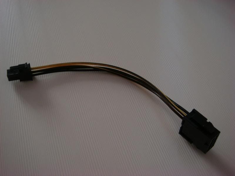

the 8-pin to 4-pin EPS converter

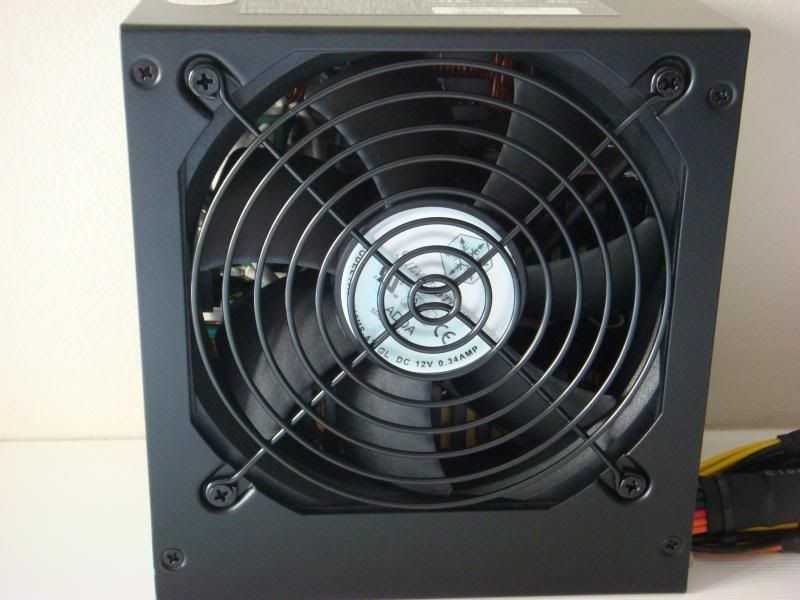

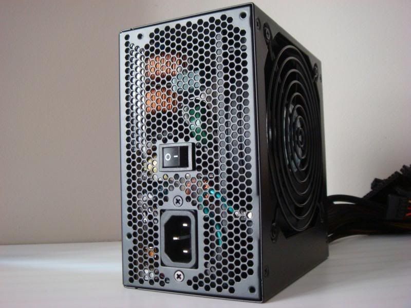

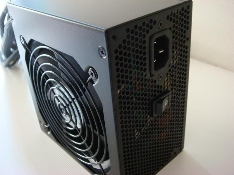

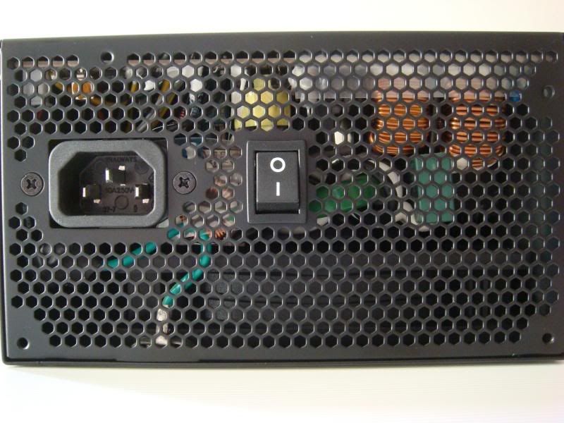

here is what this baby looks like :
A look on the Super Silent fan that came with it
the back of the PSU. Honey Comb ventilation holes. Notice how the switch is in the middle?
Another look at it. Its standing tall

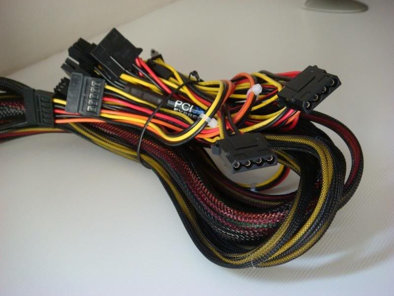

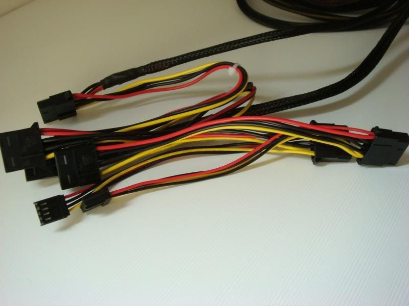

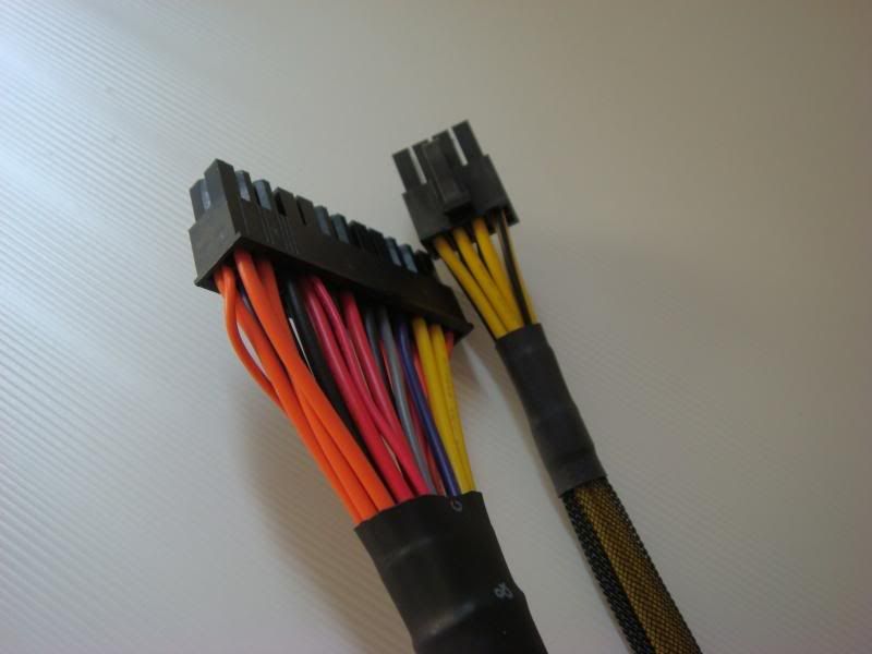

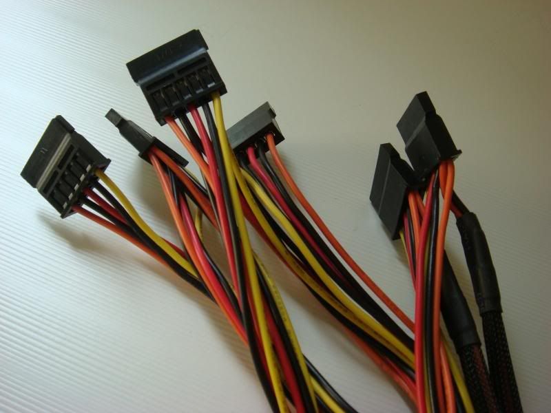

The cables :
Phew, thats a lot of cables!

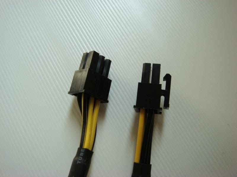

A look at the 24-pin and 8-pin connectors
the 2 6-pin PCI-Express Connectors.
The Sata Power connectors. Non 90 degree ones like the ST50F.
And of course, the 4-pin molex connectors

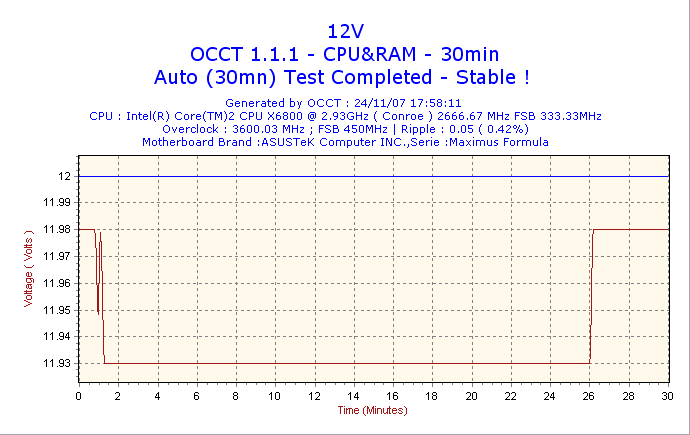

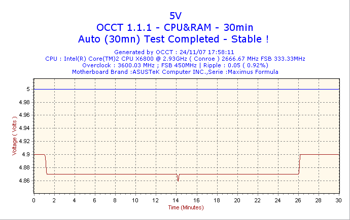

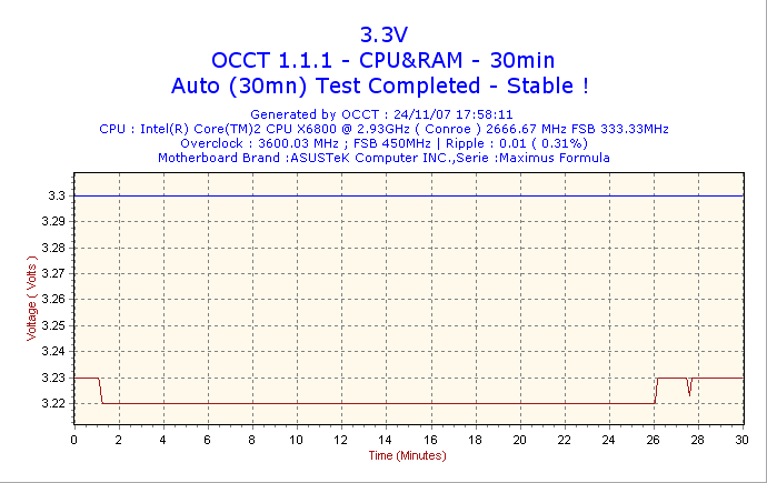

Results :-
here are the results with the DMM!
here are the OCCT results
3.3 Volt
5 volt
12 Volt
Conclusion :
My doubts of this PSU handling my system disappeared when i reviewed the ST50F, but i still was concern that 560W was not enough. Luckily, I was proved wrong for the second time. This Power Supply is definitely suited at systems that do not need crazy amount of power to power their system. Low end SLI equiped systems will not face any difficulties using this PSU unit in their system. Overall, this PSU is silent and strong.The voltage fluctuations for load and idle were minimal according my my trusty DMM! Moreover, the silence of the fan was maintained although the system was stressed. Oh yes, and as you can see, the 12V from the OCCT is super smile.gif
