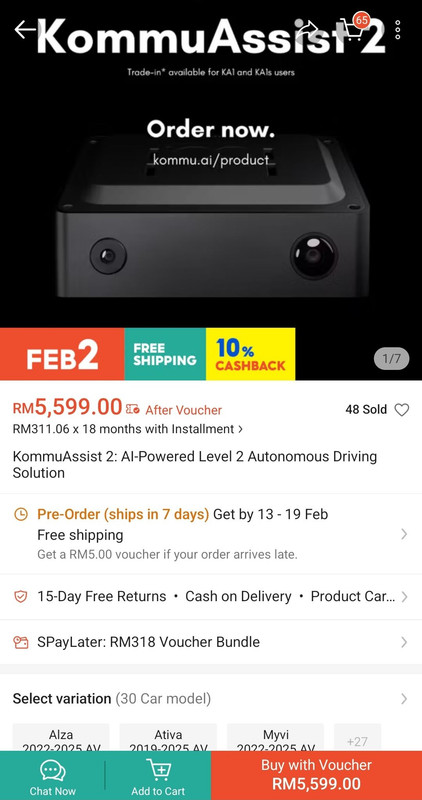

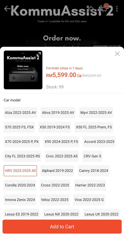

https://kommu.ai/
for HRV 2023-2026

If bought low spec. and want to add or mod with original Honda Sensing is expensive, Subaru member got try to add on their 1st gen Xv with similar technology knew as eyesight. You need to buy half-cut and transfer all the wiring, sensor, meter, switch (can consider whole dashboard transfer over) even front windscreen need to change to suit with the ADAS system. Minimum at least 1xk to convert from half-cut with eyesight, ADAS calibration everything done.
https://kommu.ai/support/
Kommu can only support those already got Honda Sensing, if no, need to mod as per what i feedback previously buy half-cut transfer
Support
Supports only Honda vehicles that comes with Honda Sensing
