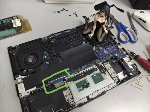

My Asus Tuf Gaming A15 laptop.
Me proud because even laptop technicians said they cannot take this job because the solder pins are too small. WEAK!! Phuik! Even a normal average joe like me can do it

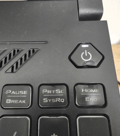

Issue: Inherent problem, whereby after 1 year will kena the power button intermittent cannot turn on. It will slowly slowly deteriorate until you press press 30 mins also cannot turn on.
Asus solution: Change whole keyboard including power button. Cannot just change power button due to the design.
Problem will come again after 1 year+
Note: my laptop still under warranty until end of dec. But i didnt proceed because solution not permanent.

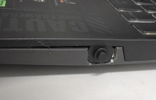

Temporary solution : Use hair dryer to blow around 15 seconds before press power button to turn on. Works, but it needs longer and longer time so my buttons are melting.
My solution : Soldered DIY secondary power button permanently on my laptop. Now i just press secondary power button to turn it on.
Melted buttons below.

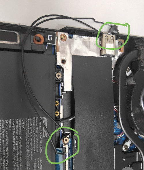

Soldered additional power button at pin 5 and ground.
The process
Completed secondary button

I also dunno. After bought the laptop only know got such issues. You see that triangle power button, all asus laptops with this design have this issue.
