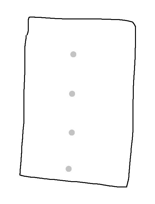

QUOTE(jeniferlim @ Dec 3 2025, 09:47 AM) So far, I used compatible toner TN1000, it's OK. No major issues... I'm using Brother HL1110. printout normally becomes like this - marks running vertically down. was told that it is dirty drum. I think I have changed the drum before, but becomes like this again.Sometimes, problem is due to DRUM. If the printing is not good, have to change the DRUM unit too. ![]() |
