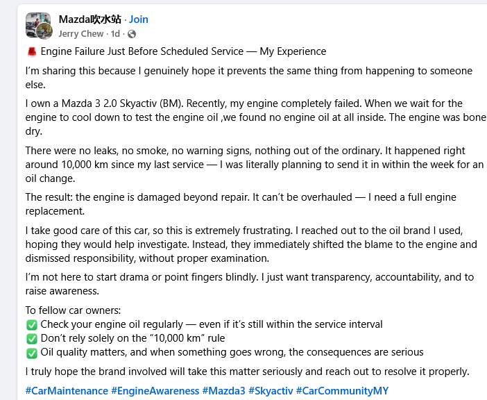

unsure why, cant embed the fb post, i screenshot
Please check your engine oil regularly, buy genuine engine oil from authorize dealer, dont trust something unusually cheap
Mazda out of engine oil, need to change engine

unsure why, cant embed the fb post, i screenshot ![]() ![]() Please check your engine oil regularly, buy genuine engine oil from authorize dealer, dont trust something unusually cheap |

Learn to do own maintenance lor. Checking oil levels is easy. Pop the hood, lift the dipstick and see the level. If below Min, top up and then send the car for checkup. Unfortunately, people here only buy cars for looks and comfort. Maintenance knowledge zero. Everything let the SC do. Once the SC or owner fucked up, all buat dunno. 10k km service interval is a scam. If the car is a daily driver, send in for service after 7.5k km and don't wait any longer. Been doing this for all my cars and none ever had engine failures for the past 35+ years. This post has been edited by acbc: Nov 9 2025, 12:26 PM version46, H3artBreakKid, and 6 others liked this post

Engine running without engine oil, dont have any symptoms at all? Make sense or not? gobiomani, raymondwong1808, and 15 others liked this post

didn't refill after the last service? but surely the engine would scream if it's bone dry

Mazda car sensors so lousy meh? No more engine oil light never come out meh? Freshmeat21, MegaCanonF, and 3 others liked this post

This is a case of probably SC forgot to replace engine oil from last service. No way engine oil is bone try unless the engine block like crack.
Sometimes send to SC we trust them by paying that premium. He needs to start lawyer up then nego with the SC on how they want to settle. |

Surely a new car would have displayed the Low Oil level warning right during startup or midway driving right? Or some drivers just ignored only. I know women drivers hardly paid attention to the warnings and drove like normal.

QUOTE(ryujin0x @ Nov 9 2025, 12:26 PM) This is a case of probably SC forgot to replace engine oil from last service. No way engine oil is bone try unless the engine block like crack. Impossible. Sometimes send to SC we trust them by paying that premium. He needs to start lawyer up then nego with the SC on how they want to settle. If forgot to replace, the Low Oil level warning will pop up multiple times. |

“To fellow car owners:” “Check your engine oil regularly” In other words: I didn’t check that’s why my engine dry emefbiemef, Irzani, and 1 other liked this post

Bugger said driven 10K KM since service. Obviously it couldn't have been no oil since last service. So bocor along the way. loserguy liked this post

No engine oil car can still drive??

Old engine oil also can feel not so nice to drive.
Dry engine oil don't feel anything?? |

Few scenarios.
1. Ignore Low Oil level warning. This warning will pop up before start and after start constantly. Very irritating on European cars and distracting on Japanese or Korean cars. 2. Oil filter may not be tightened enough. Slow small leak occured during driving. That's why no leak when parked. 3. Engine problems. Oil may have escaped via PCV to the intake. Check for oil traces. |

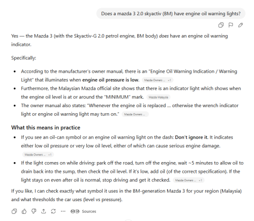

Nov 9 2025, 12:39 PM

engine oil sensor rosak?
