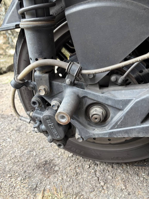

Recently got work done on exhaust, found crack on the rear arm. is this serious? do i need to replace the part immediately?

Check if can get replacement. If yes, how much that'd cost?
If cannot get replacement part, then just bring for welding. |

QUOTE(optimus9333 @ Oct 29 2025, 11:21 AM) Recently got work done on exhaust, found crack on the rear arm. is this serious? do i need to replace the part immediately? i would think its a serious problem. may break during ur ride.bike is modenas elegan 250 ex secondhand only been using for a month only exp before using kapcai and small scooter only ![]() ![]() ![]() ![]() get it replaced, if not, at least repair it. |

QUOTE(scorgio @ Oct 29 2025, 11:24 AM) Check if can get replacement. If yes, how much that'd cost? found the part in shopee around rm350, thinking to just buy and bring to shop to replaceIf cannot get replacement part, then just bring for welding. This post has been edited by optimus9333: Oct 29 2025, 12:33 PM |

QUOTE(optimus9333 @ Oct 29 2025, 12:33 PM) yes, just replace it. Welding cast aluminium is not something I trust local welders to do properly. bo093 liked this post
