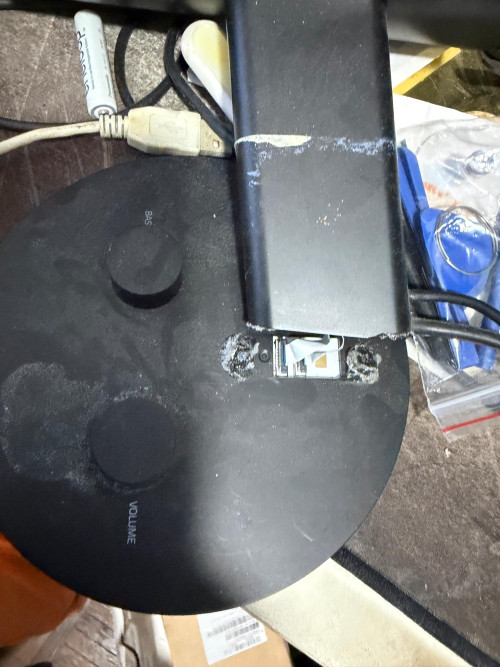

Hi guys, i think a year or so ago i was moving in between 2 rooms and accidentally damaged my Razer Nommo Chroma. Any chance anyone knows who can repair this for a price or is it not repairable? Appreciate the info. Sorry if post in wrong place. sweat.gif

Glue it back if it's still functioning.

Use Epoxy Adhesive Glue

I’m not sure if it still works. Haha. But I’ll try to turn it on and see. lol. I did use superglue first. But didn’t last. 😅

Superglue has a few varieties (the numbers refer to different classes of viscosity and base materials) available. It's best to avoid applying superglue to plastic materials as it could cause more damage than fixing them.
QUOTE
Super glue number codes
Loctite 406: A low-viscosity super glue specifically for bonding plastics, as described by Viking Industrial Products Ltd.
Loctite 435: A low-viscosity, rubber-toughened, and flexible option for materials like rubber.
Loctite 403/408/460/455: These are part of a line designed to be low-odor and low-bloom, which reduces frosting on surfaces, even in enclosed areas, according to Gluegun.com.
Loctite 4851: A gap-filling glue suitable for bonding porous materials like paper, leather, and fabrics, explains ConRo.
Super Glue 502: A general-purpose instant adhesive that is cost-effective for quickly bonding many common materials, including metal, plastic, glass, and wood.

gluegun probably not a good idea, epoxy or resin should be better.
but I usually prefer box speaker :X this type of leg usually flimsy :X
