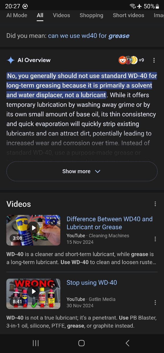

WD40 is the right choice.. for indoor
grease for outdoor gate if it expose to rain, becoz it would get wash off..
Just applying my common sense
WD40 no matter indoor or outdoor, it will dry out by itself, it's NOT a lubricant
if you want a lubricant that can stand rain, it's real original grease
TSbengang15
post Sep 14 2025, 04:28 PM
419 posts
Joined: Feb 2022
QUOTE(taitianhin @ Sep 14 2025, 03:21 PM)
I really don't think wd40 is the right choice. It's good for cleaning but in the long run it will cause rusting. So I was told
