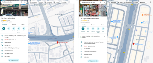

Please go to any electrical shop to buy, is heavy and many electric shop outside can get easily.
Basically any large electrical shop will do
2.5 mm around RM250 -350 + - and 4.0mm around RM 400 + - (depends u want to have Sirim or no Sirim)
