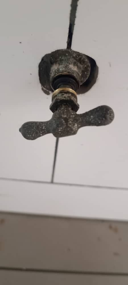

Anyone know how to fix this issue?
When I closed it, there is no noise and vibration. If I open it, the noise and vibration are there, unless I turn smaller.

Try open the stopcock and let the water out.

Try opening the valve all the way first to see if it helps.

sounds like the washer in the valve is spoiled...

Not because there is air in the system?

The pipe is vibrating

try off the stopcock , then open faucet or shower drain it out first then on back see .

Dismantle pipe valve and also others pipe in the toilet. Let it flow the water until the air trapped inside the piping flew out.

I opened. And also let the water flows out from there. Still the same.
But I have yet to try to off the stop and open other faucet or shower drain to let all water out?

From your picture im inclined to say you need to replace the rubber washer as it looks very old already.

if the hose is concealed, there's not much u can do
i suspect there is air inside

How to replace? Can't take it out.
QUOTE(MR_alien @ Aug 19 2025, 10:03 AM)
Yes, it is concealed and I have no way to open the whole without ketuk the wall first.
What is the effective way to flush out the air inside?
The vibration is until another toilet's pipe and the sound is very loud like wuuuuuuuuuuuuuuuuuuuuuuuuuuuuuuuuu

Yes, open pipe valve in your toilet. It the water flush the trapped air out.

the one is my picture?

From your picture, looks like no need to ketuk as the stop valve is protruding out of the wall.
https://youtu.be/XAPnepUbWvE?si=hDHpCT10iLbXAUme

let me find out on how to "kepik" the thing to take off the whole
it looks like no kaki tangan to kepik because the tiles sangkut

Using deep sockets will help tremendously
