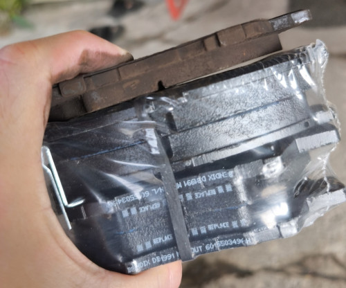

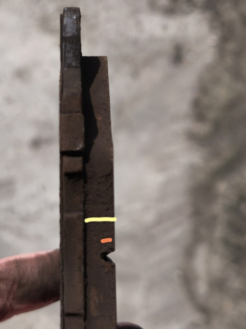

My front disc brake pad , clocking in 50k mileages.
Recently hand itchy cleaning the wheel tires and open up the screw and look into the brake pad.
How u guy measures the brake pad depth?
I measure from the central groove, the orange line and it is 4mm, or shall i use the measurement from the yellow line?
Btw i just bought metal king. Thk of changing it later.

Old one still got 50% left.
Good for 20k km.
Or 10k km if u ari2 Genting.

sudah buka, tukaq je

When the V notch is gone, it is time to change the brake pads. From the looks of it, still have 50% left.
