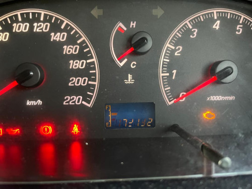

Seems like the display got partially faded. Any solution ?

Need advice for my issue, Myvi 1st gen meter LCD

not sure for myvi, but most likely need to change meter set

second hand set

1) standby 300-400 replace 2nd hand meter. online shopping discount voucher. diy pasang. with expect will happen again in the future . 2) find specialist replace lcd polarizer film. can choose other color tone too. speedy3210 liked this post

QUOTE(ktek @ Aug 8 2025, 08:57 PM) 1) standby 300-400 replace 2nd hand meter. online shopping discount voucher. diy pasang. with expect will happen again in the future . so conlanfirm is polarizer film issue? just worry is the LCD itself internal damage2) find specialist replace lcd polarizer film. can choose other color tone too. thx Bro |

There’s a shop in KL that’s able to repair the lcd just unsure how much and how long will it lasts…

last time my accord meter also become like that. but its under warranty.
still get the breakdown from sc, as usually sc charge is bloated. 3k to replace the meter. |
