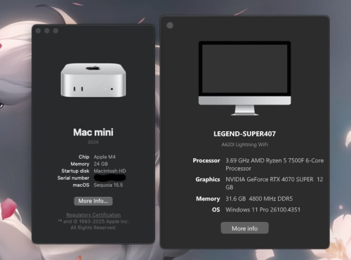

1. My Mac mini desk setup is nearly done.
Via Moonlight, I can utilize Mac and Windows at pretty much the same time using the same keyboard/mouse.
M4 works really well as a client (moonlight) while my windows desktop works as a host (Apollo).
Now I can have the best of both worlds (productivity + a bit of gaming)

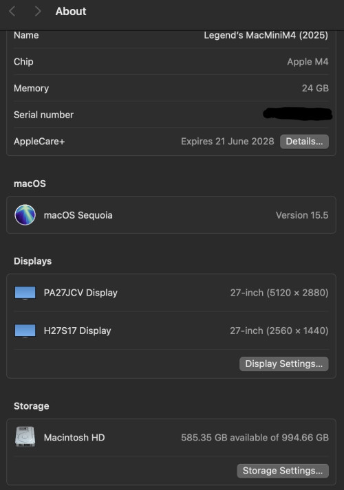

Here is the more info on the mac mini showing the 994.66GB

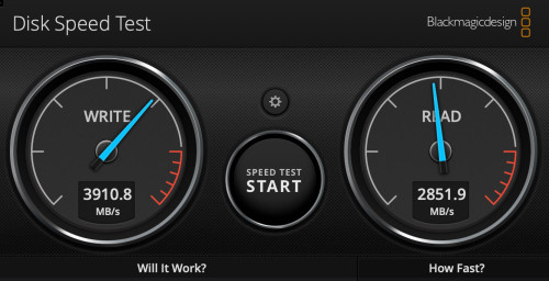

Speed wise it's pretty good. Faster than the 256GB SSD originally in the MacMini

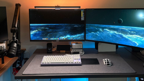

3. Managed to make a dual monitor (27") setup work on my 1.1meter short desk. Partly possible because of how little space the Macmini takes.
Still missing some small speakers for it. Mac mini speaker leaves much to be desired.
Will be getting some micro sized iloud speakers over the weekend.

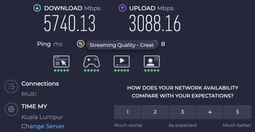

4. I got the 10gbps upgrade port for the macmini too.
Seems to be working fine.
No matter how good wireless connection is, it certainly can't beat the speed and stability of a wired connection.
