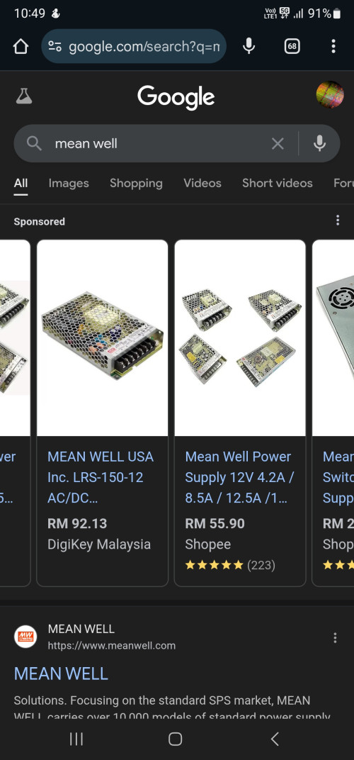

1) buy from good manufacture like mean well (MW) beware of fake one. ![]() 2) check how many A (AMPERE) your device u are using and buy with higher Amp Example Your device using 10A total then u buy 15 A or more. I think your current device always blow due to below A or sort circuits Contoh : 10A but only give 5A for it. subaiku liked this post
