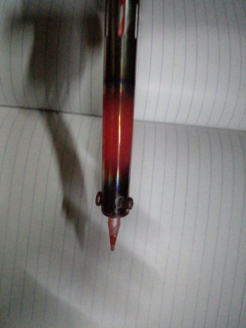

I bought a 60W soldering iron from MR DIY. After about 7 minutes of powering on, the middle part of the iron turned bright red, and a few minutes later, the tip also turned red. Is this normal? I have already exchanged it with the seller, but it's still the same.

It should not turn red. But it happens because they used too thin or low quality steel that caused this problem.

For quality soldering iron no, for this type of cheapo soldering iron yes.
Honestly i would recommend get a proper china brand soldering station than using this.
You are going to have a very, very tough time getting any proper soldering done with this cheapo tool.

Either low quality metal or coating.

I have already exchanged one with the seller, but it is still the same.
When I changed to the second one, it looked fine after 6 minutes on site. I took it home and used it for 10 minutes and it turned like this. They said they can't refund the money, only exchange it, but I have already exchanged it once and it is still the same. They don't have any other brands.

I am presuming you don't have a voltage regulator and you just plug and play. Regular socket wall produce 60w and above. Your cheap solder is running about 35 - 40w range. W/O a regulator it's just going to keep heating until it melts.

Oxidization happens much more often with cheap solder .... sooner or later the shape gonna bend. for better quality ones they have separate rod that act as a cooler between the inner and outer rod, the cheap one don't have.
You can still use it, just that its kinda leceh ...... what you need to do is only turn on when you are ready to use and wait a bit. Make sure you have a wet sponge holder and a wet sponge use it to cool and clear the tip, like rub against it after a few solder points. Turn it off after finish use and don't leave it unattended until its safe to do so.
Its like using a manual car, just make sure when its red hot the thing touch nothing .....that is when you have the solder holder to keep it in place.

yes, the solder iron have problem.
The thermocouple inside should sense the temperature and cutoff when reach the desired temperature.
But your wan keep running till become red. That’s too high temperature. The handle will get hot and the tip will oxidise fast.

Using voltage regulator is not going to solve the problem here.
